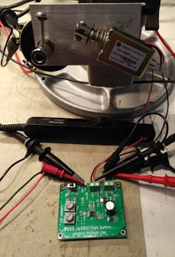

To compare the electromechanical performance of different solenoid drive schemes, a simple test setup was built using a servo potentiometer connected to a solenoid with a flexure to measure the motion of the solenoid. Motion, along with voltage and current, were captured using an oscilloscope. An MPS MPQ6610 IC was used to drive the solenoid.
The setup is shown in Figure 2.
2. The test setup involved a servo potentiometer connected to a solenoid with a flexure.
