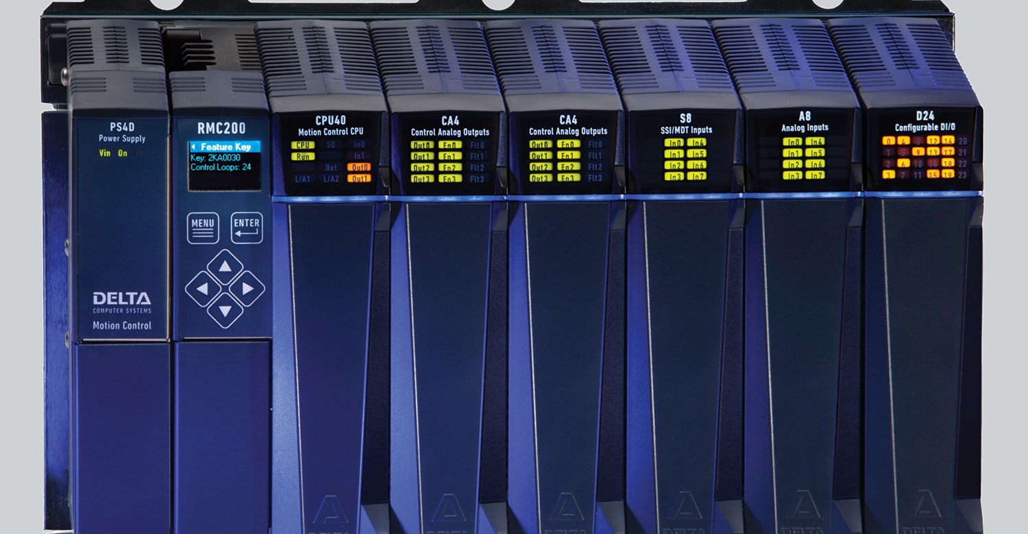

This being said, some electrohydraulic motion controllers, such as the RMC200 from Delta Computer Systems Inc. (Fig. 2), can compensate for some design problems. For example, Delta Computer Systems engineers recently analyzed a system that was exhibiting the effects of static friction, sometimes called a stick-slip problem.
2. The RMC200 electrohydraulic motion controller from Delta Computer Systems can control and synchronize up to 32 motion axes simultaneously.
The application, a gang saw “wiggle box” that needs to move in following the curve of a cut log, was vibrating when it should have been moving smoothly. The problem was diagnosed as being caused by the bores of two of the cylinders being too small, meaning that the system had a low natural frequency and was not as stiff as it should be. Hence, it wasn’t responding quickly enough to control signals from the motion controller.
The D velocity term in the PID loop equation wasn’t producing enough drive to each valve. The Delta engineers solved the problem by increasing the gain of the acceleration component of the control loop algorithm (the D Differential gain in Fig. 3), which gave increased fluid flow to the cylinder to provide extra energy to the motion. In this case, the second-derivative gain is applied to the error between the target and actual cylinder acceleration values, overcoming the effects of stick-slip and compensating for the too-small cylinders.
