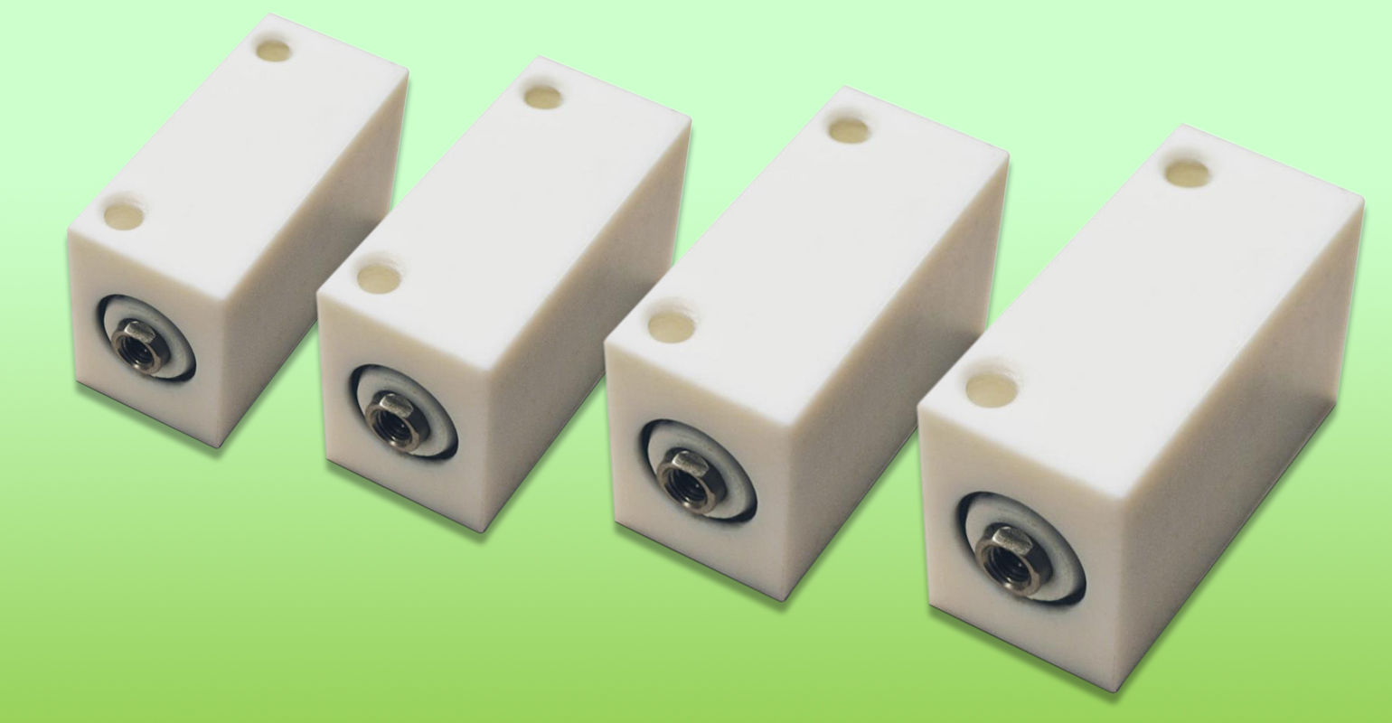

Composite Cylinder Series are 25-30% lighter than conventional cylinders of the same size and rating.
Composite Cylinder Series are 25-30% lighter than conventional cylinders of the same size and rating yet have the same envelope dimensions and mounting as company’s standard series. The fully repairable cylinders are made of corrosion-resistant, FDA-approved food-grade materials and are available in six standard bores from ½ to 2 in. with strokes to 4 in. Metric versions come five in standard bores from 8 to 40 mm and strokes to 100 mm. Options include hollow rod and magnetic piston with standard operating pressure to 150 psi.
