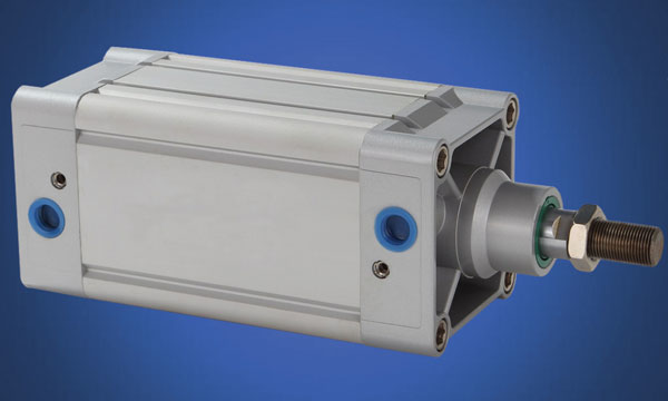

Hydraulic cylinders may provide plenty of muscle and precise positioning for heavy industry and off-highway equipment, but air cylinders come in a wide array of specialty designs and configurations—making it a cinch to solve challenging applications that even some custom-made conventional cylinders can’t.
Like all cylinders, these specialty cylinders use pressurized fluid (air, in this case) to produce linear motion and force to move, push, or pull a load. But compressed air generally exhibits pressure of about 100 psi—a fraction of that used in hydraulics. This means an air cylinder would need a large bore to transmit high force. But at least one design of specialty air cylinder uses more than one piston to multiply force from a given bore.
