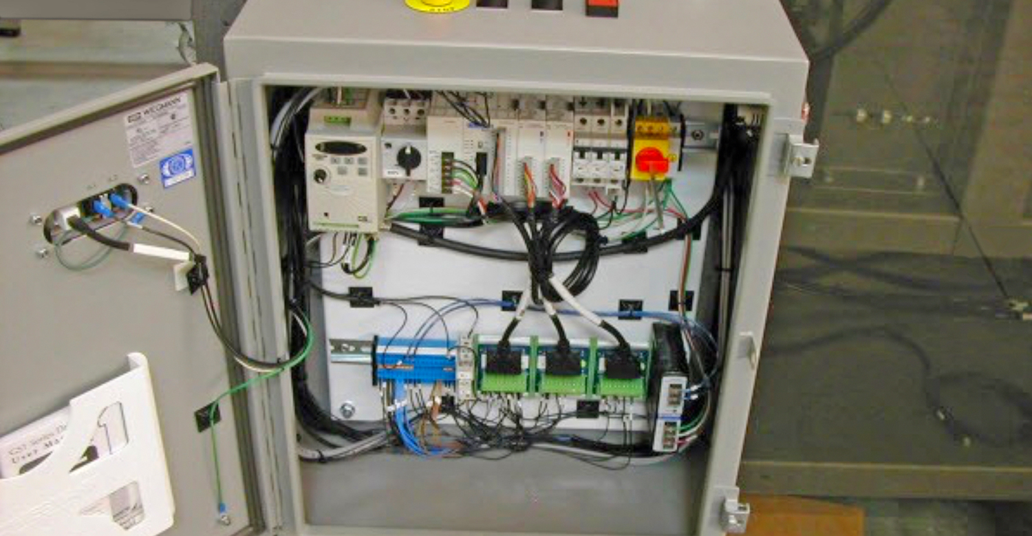

The tray maker is controlled by a Model C0-00DR PLC from AutomationDirect, which has an expansion I/O and terminal blocks for field wiring. A bulkhead programming port with its outlet on the control enclosure door simplifies compliance with arc flash regulations by allowing changes to be made to the controller software without opening the door (Fig 5).
5. A Model C0-00DR PLC from AutomationDirect has bulkhead programming port outlet on the control’s enclosure door to allow revising software without opening the enclosure door.
