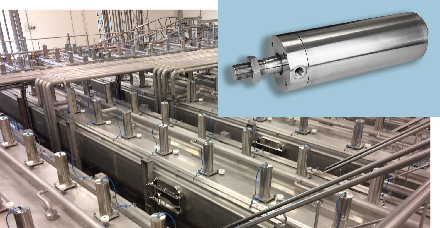

Before forming the cheese, pneumatic cylinders are used in a pre-pressing operation to exert pressure on a large plate above the curd. The plate may be perforated to allow the whey to escape as pressure is applied. Pneumatic cylinders excel at controlling the pressure. “Pneumatics truly shine here,” says Gerson Henning, dairy expert at Emerson’s AVENTICS, says. “Both the applied pressure and application time can be set with extreme precision.” The maximum pressure applied to the curd is only about 0.71 psi (50 g/cm2), so close control is a necessity.

Large cheese presses may be equipped with several hundred pneumatic cylinders, such as the AVENTICS Series ICS, suitable for air pressures up to 145 psi and temperatures between –13 and 158°F. A high-temperature version, rated up to 248°F, also is available. These hygienically-designed stainless steel cylinders feature smooth surfaces, interlocking seals, and cushioning screws, and use a non-toxic food-grade lubricant.
Henning points out that, on the large presses, several hundred of these cylinders often move extremely large plates. Pneumatic cylinders also are included in other parts of the system, where they perform functions such as moving the cheese during the course of its ripening.

Hundreds of pneumatic cylinders are used in some cheesemaking operations, providing the controlled pressure needed for consistent quality.
