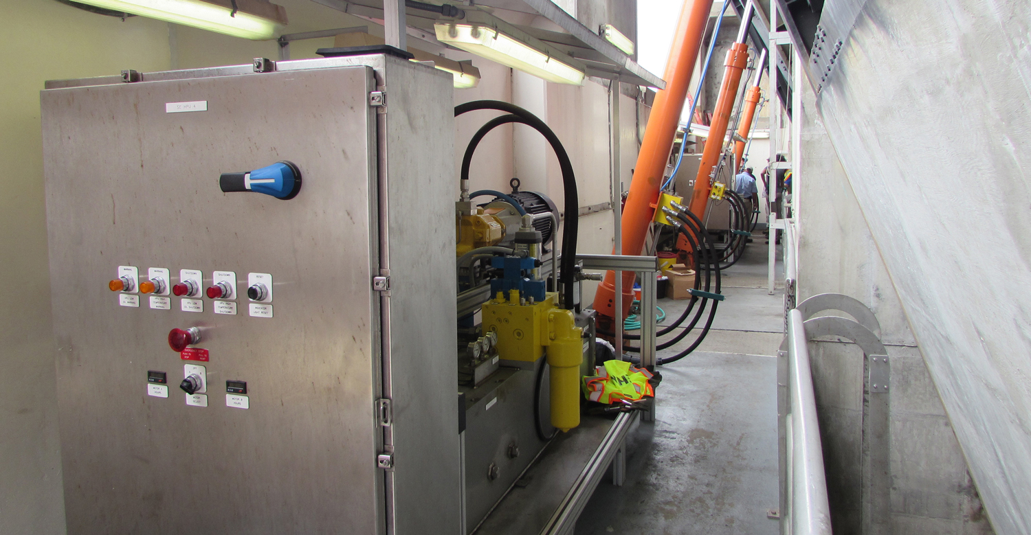

Fig. 1
Progressive Cushioning for Hydraulic Cylinders

Why would you need it? The advantages of progressive cushioning are best realized when you have a very large, heavy structure, such as a flood gate, navigational lock gate, or movable bridge span powered by a hydraulic system. If you are designing such a system, the obvious need to decelerate and stop the structure from moving at each end of the cycle can be accomplished in many ways. Gradually reducing hydraulic fluid flow near the end of stroke can be achieved with various valve circuits, but they all rely on some form of electrical control system or limit switch to initiate and control the deceleration process.
The problem is that sometimes limit switches and control systems fail to operate. There’s little need to explain the effects of what happens when a heavy structure fails to decelerate and slams into its abutment. The resulting damage can be anywhere from mildly annoying to catastrophic.
