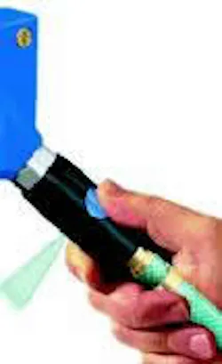

Push button on Prevost safetystyle coupling starts 2-stage disconnection procedure. Safety and productivity continue to be key factors when selecting components for almost any industrial application. Simple pneumatic ...

Safety couplings incorporate a 2-stage disconnection process. In the first stage, the initial disconnection action closes a valve in the coupling. Downstream pressurized air inside the hose then quietly vents from at a controlled, reduced rate while the nipple remains connected with the coupling. In the second stage, the operator mechanically releases the nipple from the coupling by performing a separate secondary disconnection action.
Installing safety quick couplings in place of regular couplings at air drops greatly reduces the chance of dangerous hose whip occurrences. In addition, safety couplings dramatically reduce the noise level when hose assemblies are disconnected. The difference in noise levels between disconnecting a hose from a regular coupling and a safety coupling at 100 psi can be as much as 19 dBa.
