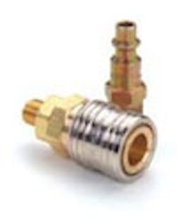

Regardless of the manufacturer, all quick-acting couplings have some elements in common. All have two parts: a plug and a socket. The plug is the male half and the socket is the female half. When connected properly, these parts seal and lock the joint effectively to contain internal pressures and resist any tensile forces that tend to pull the joint apart. The parts are easily disconnected without tools by disengaging a locking mechanism and separating parts.
1. Ball-lock is the most common design and has the widest range of applications. A group of balls is positioned in holes located around the ID of the socket body. These holes normally are tapered or stepped to reduce their diameter atthe socket body ID, so the balls do not fall into the cavity vacated by the plug when the coupling is disconnected. A spring-loaded sleeve around the socket body's OD forces balls toward the socket body ID. To connect the plug, the sleeve is pushed back, which opens clearance so the balls are free to move outward. Once the plug is in place, releasing the sleeve forces the balls inward against a locking groove on the OD of the plug. To disconnect, pushing the sleeve back provides the balls with clearance to move outward and allow the plug to be removed.
