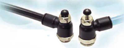

Flow-control regulator fittings use an adjustable restrictor to meter flow and control cylinder speed.

Flow-control regulators
Flow-control regulators control the speed of pneumatic actuators. In the one-way version, an adjustable orifice restricts the exhaust or inlet air flow. The inlet or exhaust flow, respectively, is unrestricted. In a bi-directional version, they control both exhaust and inlet flow. Depending on the model, flow regulators can mount onto a cylinder or in the compressedair line.
However, flow regulation (and, therefore, control speed) is more precise and constant when the flow regulator is positioned near the actuator. This can minimize the elastic effect of the compressed air contained in the pipework between the control valve and actuator. Therefore, direct mounting of a flow regulator fitting onto the actuator is recommended. Typical operating range is 1 to 10 bar pressure at 0° to 70° C.
