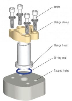

Figure 1 — Typical four-bolt flange port connection components. Click on image for larger view.

Basic design
The 4-bolt flange port connection consists of four primary components: flange head, O-ring, flange clamp (captive or split) and four bolts. The port is simply a flow passage surrounded by four tapped holes that accept the clamping bolts. Typically, the flat-machined surface of the port compresses the O-ring contained in the groove of the flange head when the bolts are tightened. The bolts, placed through the flange clamp, squeeze on the flange head, compressing the O-ring in the groove leaving no leak path or possibility of O-ring extrusion, Figure 1.

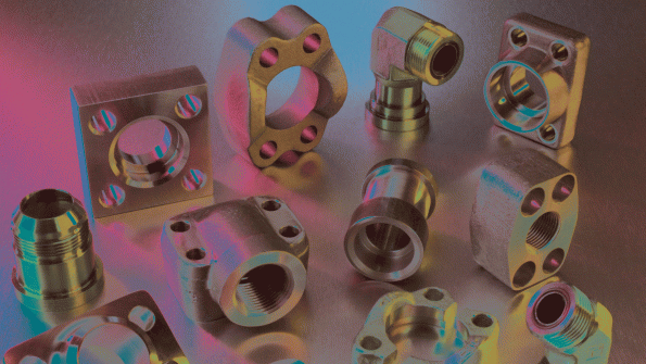

Figure 4 — The variety of standard flange configuration options make them suitable for most hydraulic applications. Click on image for larger view.
In fact, flange connections provide for zero-clearance assembly that enables easy connecting, disconnecting and maintenance of tube-to-tube, tube-to-hose and manifold connections. Infinite positioning is a “built-in” feature, in that the flange can be positioned at any angle. In addition, flange connections have the highest resistance to loosening, due to the clamping load distribution over the flange head. This makes flange connections an ideal choice for bent hose end connections that are subjected to very high lateral forces that tend to cause loosening.
