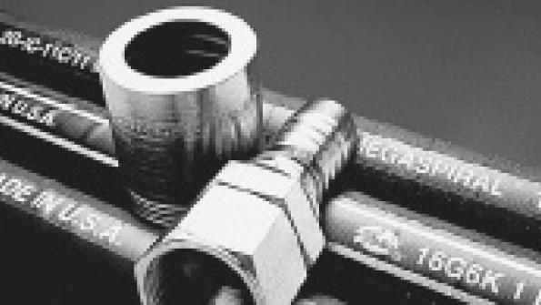

All major manufacturers offer fittings and hose couplings that conform to SAE and ISO standards that reduce leakage. Many also have proprietary designs with design characteristics that reportedly reduce leakage even further. The example shown, the Global Spiral hose coupling, is designed for leak-free performance with hose rated to 6000 psi. Longer teeth than in standard couplings grip the ID of the hose, which helps prevent leakage from high-pressure pulsations.

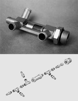

Integrated custom component, top, provides many benefits over multiple standard components, above. Custom components are said to become cost-effective at quantities of less than 200.

The component shown at right is a heat exchanger bypass valve for a cotton picker/sprayer. This integrated part protects seals in the equipment's hydrostatic transmission from damage caused by excessive pressure. Designed and manufactured by Fluid Line Products Inc., Willoughby, Ohio, it consists of an in-line relief valve set to open when exposed to 45-psig backpressure — well below the 60-psig rating of the seals.
Without the bypass, pressure in the HST's return line would likely exceed the maximum pressure rating of the seals when the machine is operated during cold weather. This is a common occurrence with mobile equipment because at low temperature, hydraulic oil has a high viscosity, which dramatically increases backpressure throughout the hydraulic system.
The bypass valve prevents intermittent leakage by keeping pressure applied to the seals below their maximum rating. Furthermore, it prevents permanent leakage by protecting the seals from excessive pressure. The bypass valve also prevents leakage by drastically reducing the number of mated joints (potential leak points) by nearly 70% from what would occur with standard components.
Darko Brozovic, project engineer manager at Fluid Line Products, explains that to duplicate the bypass valve using standard components, 11 fittings would have be be connected to a standard relief valve. Brozovic constructed the assembly drawing to illustrate how the bypass valve would be duplicated using standard, off-the-shelf components.
Although these components all are available readily available, the time and care to assemble them would add substantially to the overall cost of the bypass valve. Moreover, the potential for leakage would be more than three times as great, because the valve made from standard components requires 16 mated joints — as opposed to only five for the custom valve.
Not only must the components be assembled carefully to prevent leakage, but because the hose fittings must be connected in a specific orientation, leakage would likely occur if these fittings had to be repositioned for proper alignment during assembly. And if a leak did occur at one of the internal connections, the entire assembly would have to be removed because tightening one connection would loosen another. Consequently, any of the 11 mating connections could leak if even one is tightened or repositioned.
Additional benefits of using the custom bypass valve include a lighter, more compact design and a neater, cleaner appearance. In addition, because the component is custom designed, end users are much more likely to obtain a replacement part from the original equipment manufacturer. This not only supports a "genuine parts" strategy, but helps ensure that the machine will continue to operate more reliably. If a user made a replacement assembly from standard parts, the likelihood for leakage or breakage would be much greater — assuming the user could even connect and install the jury-rigged assembly.
Most designers, however, assume that a custom component, such as the bypass valve, is not cost effective unless ordered by the thousands. But John Hetzer, president of Fluid Line Products, Willoughby, Ohio, explains that this is not necessarily so. Hetzer says that the break-even point for most custom assemblies — even those far less complex than the bypass valve — falls around 175 pieces. Considering the many benefits of integrating multiple components into a custom design, leakage prevention is only a drop in the bucket.
