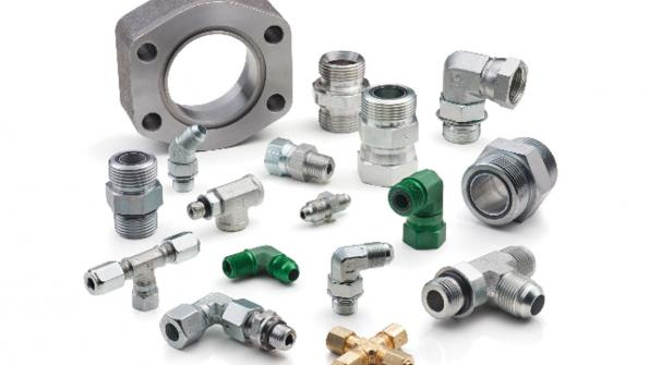

Fitting purpose and construction
Common metal materials used for fittings include coated carbon steel, left, which are used in high-pressure, heavy-duty applications; and stainless-steel fittings, right, for applications where internal media or the environment is corrosive.
Two general fitting categories are based on geometry ­— straights and shapes. Straights are typically machined from cold drawn, hexagonal, or sometimes round bar stock. Shapes are typically forged or brazed. Because forgings are single-piece construction, they have no potential leak paths, which can occur with a two-piece brazed fitting. Also, forged fittings are normally stronger because they are not limited by the strength of the brazed joint. This added strength typically produces longer life and higher-pressure ratings than brazed fittings.

Hydraulic fitting materials must have adequate strength and corrosion resistance to safely handle the high pressures characteristic of hydraulic systems. In addition, the fitting material must resist rust and corrosion from the different media inside and outside of the vessel. Other selection factors include cost and outside environmental conditions.
Generally, metal fittings are used in most hydraulic systems due to their high pressure ratings. Plastics have naturally higher resistance to corrosion than metals but have lower strength and durability, making them less suitable for hydraulic systems.
Carbon steel is durable, strong, and has a high resistance to heat, with a temperature range of –65° to 500°F (–54° to 260°C). An alloy of iron and carbon, it is typically alloyed with other metals to improve strength, toughness, and other properties.
External protective coatings such as electroplated cadmium, zinc, and zinc phosphate are applied to carbon steel fittings to extend their service life in corrosive environments. However, in the past decade, cadmium is no longer accepted by most industries due to environmental considerations. Cadmium and zinc corrode sacrificially, protecting the steel substrate from normal atmospheric rusting due to the common presence of oxygen, moisture, and acidic gases. However, they are rapidly attacked by many fluids — including those containing acidic hydrogen, reactive fluorine, chlorine, bromine, iodine, and nitrogen. Zinc-nickel external coating provides enhanced carbon steel protection in ASTM B117 salt spray testing and in fertilizer (urea) applications.
Stainless steel fittings, along with brass fittings in low-pressure applications, are viable options. In applications where low toxicity and low corrosion are required — as in food or beverage applications — steel coated with any form of zinc or other protective coatings is not recommended.
For lower-pressure applications, lighter metals are available, including brass fittings, above, which are best suited for lower pressures and temperatures; and aluminum, below, for lighter weight applications requiring corrosion resistance.
Fluid pressure (both operating and peak) must also be considered. Allowable design pressure ratings for carbon steel fittings are rated up to 18,000 psi, depending on the steel grade or alloy. Carbon steel fittings are widely used in industrial, construction, and agricultural equipment because of the requirement for high pressure, high strength, and low cost.
Stainless steel is strong and has excellent chemical and corrosion resistance. Its temperature range is –425° to 1200°F (–254° to 649°C). Stainless steel is an alloy of steel that contains more than 10.5% chromium. It has the strength and durability of steel while also providing excellent corrosion resistance, making it the most suitable fitting material for hydraulic applications where the fluid or surrounding environment is corrosive. Stainless steel’s toughness is significantly better than carbon steel’s at low temperature.
Industrial stainless-steel fittings are often rated to 10,000 psi. Specially designed stainless steel fittings can have pressure ratings as high as 20,000 psi.
Typically, stainless steel fittings are more expensive than those made from other materials. However, many applications require its corrosion resistance — oil, gas, and offshore equipment; chemical processing; food manufacturing; medical and instrumentation; agricultural fertilizer; and marine applications.
Brass offers moderate strength and toughness, and good corrosion resistance with good ductility at high temperatures. Its temperature range is –325° to 400° F (–198° to 204° C). An alloy primarily of copper and zinc, brass is typically used for smaller compression and threaded fittings because of its high machinability.
Brass is not recommended for temperatures exceeding 400° F because it becomes soft and exhibits lower strength at these temperatures. Brass can accommodate pressures to 3000 psi depending on the design and size of the fitting. However, most brass fitting applications are rated for lower pressures.
Brass fitting straights, like steel and stainless steel, are machined from hexagonal bar stock, whereas fitting shapes are typically forged. Brazed construction, however, affords a wider variety of configurations.
Aluminum is lightweight and corrosion resistant. It accommodates temperatures from –325° to 400°F (–198° to 204°C). By itself, aluminum has low tensile strength and is used for its corrosion resistance and low density in low-pressure applications. To improve strength and hardness it is alloyed with zinc, copper, silicon, manganese, and other elements. Performance depends on the grade of aluminum and its heat treatment. Pressure rating of heat treated aluminum  alloy fittings can reach 4000 psi.
Aluminum fittings can handle higher pressure than brass and reduce weight when an application has a moderate pressure rating. An anodized external finish improves corrosion resistance, as well as makes the surface harder for wear and abrasion resistance. Media compatibility of aluminum is very good.
Aluminum fitting straights are generally machined from hexagonal bar stock; shapes are normally forged.
Aluminum fittings are used where light weight is important — aerospace, military and automotive. They are widely used with plastic and aluminum tubing.
