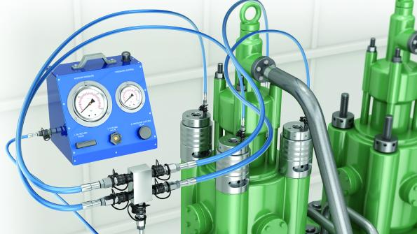

Success in using ultra-high-pressure (UHP) hydraulics in applications such as rescue tools, bolt tensioning, and hydraulic torque tools is highly dependent on a flexible hose and quick-coupling technology. Imagine a situation where a ship’s mechanic needs to tighten a bolt on a large ship engine in the confined space of an engine room and you can immediately see the need for and importance of a fast and reliable connection method. To install an application with six to eight tensioners and then have to fit hard piping between them would be quite a time-consuming process requiring several hours of bending, cutting, threading steel tubes.

This is especially true of quick-acting couplings, where materials must not only withstand continual pressure cycles, but also tolerate repeated connection and disconnection. Hose and quick connect technology now allows us to establish such a connection in just a couple of minutes — even at pressures to 400 MPa
Safety is a key concern with any connection between a hose end and the coupling/nipple. The higher the pressure, the more reliable the connection must be. In the lowest pressure range of UHP hydraulics it is quite common to use NPT thread connections sealed with Teflon tape or liquid sealant. For straight threads, such as BSP, a bonded rubber metal seal ring is also common. For pressures exceeding 100 MPa, emphasis is placed on minimizing the pressurized area and avoiding the use of tape, sealants, or washers.
