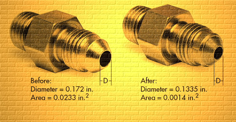

JIC 37° Flare Fittings
Tubing connections are made with cone, flare, and O-ring connectors. One of the most often used is the JIC 37° flare fitting, especially in high-pressure applications. Although industry generally accepts that JIC 37° flare fittings are reusable, they may not be reliable when reused. In fact, the JIC 37° flare fitting is the most questionable for reassembly.
JIC 37° flare fittings have a cone on the female adapter and a flare on the male adapter. The cone and flare surfaces seat against one another to create a complete mechanical seal between the male and female fitting. But each time the metal-to-metal seal is made, the cone and flare collapse more and more, causing the material to be cold-worked.  The result is a harder metal, which makes each subsequent assembly more difficult and problematic on two fronts: a leaking seal and reduced flow due to excessive nose collapse.
How can you determine if a JIC 37° flare connection is reusable or not?  Measure the amount of nose collapse and make certain that the hole diameter reduction is no more than 10%. For example, if the original hole diameter on a cone female adapter was 0.5 in. and has been reduced to 0.45 in. or smaller, you should replace the fitting. A pin gauge works well for a quick check.
