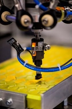

Previously, filling the cavities in the glass panes with the liquid required the hands of an employee. Plastic arrows to guide the liquid into the glass were manually placed in predefined molds, then picked up by a robot and positioned as placeholders. The company looked for an automated solution that could relieve workers from the repetitive task.

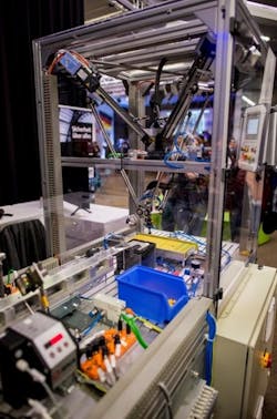

To reduce the manual labor involved in placing the arrows, Vetrotech Saint-Gobain purchased a delta robot from igus, which cost around $5,300. The robots include self-lubricating sliding plastic liners, drylin linear actuators and other components. The lightweight system has positioning accuracy of +/-0.5 mm and a maximum load of 11 lbs. The delta robot can perform 30 picks per minute in the 660 mm version, which is the unit used in this application.
The delta robot is a 3-axis unit connected by a common joint above and below the arms. Its main purpose is picking and placing objects, and can be used for standard applications with small parts.
The automated solution relieves employees of conducting monotonous tasks and also accelerates production. Employees can be transitioned to more demanding tasks in the production process. By using the robot, the company realized a quick return on investment.

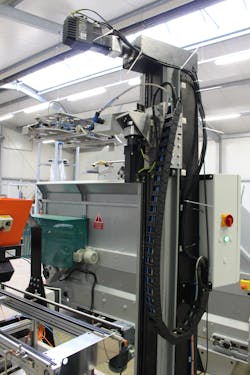

Another company in Germany uses low-cost automation products from igus to breed and grow worms. The machines lift, transport, release, stack and spray water around the clock. The worms, called dendrobena, are used as fishing bait, a natural fertilizer for gardens and greenhouses, and as food for animals. The company uses a range of igus products and developed a fully automated feeding and watering process.
“With the new plant, feeding and watering can be carried out around the clock, even when there is a shortage of staff,’’ owner Martin Langhoff said. “In addition, errors are reduced to a minimum.”
