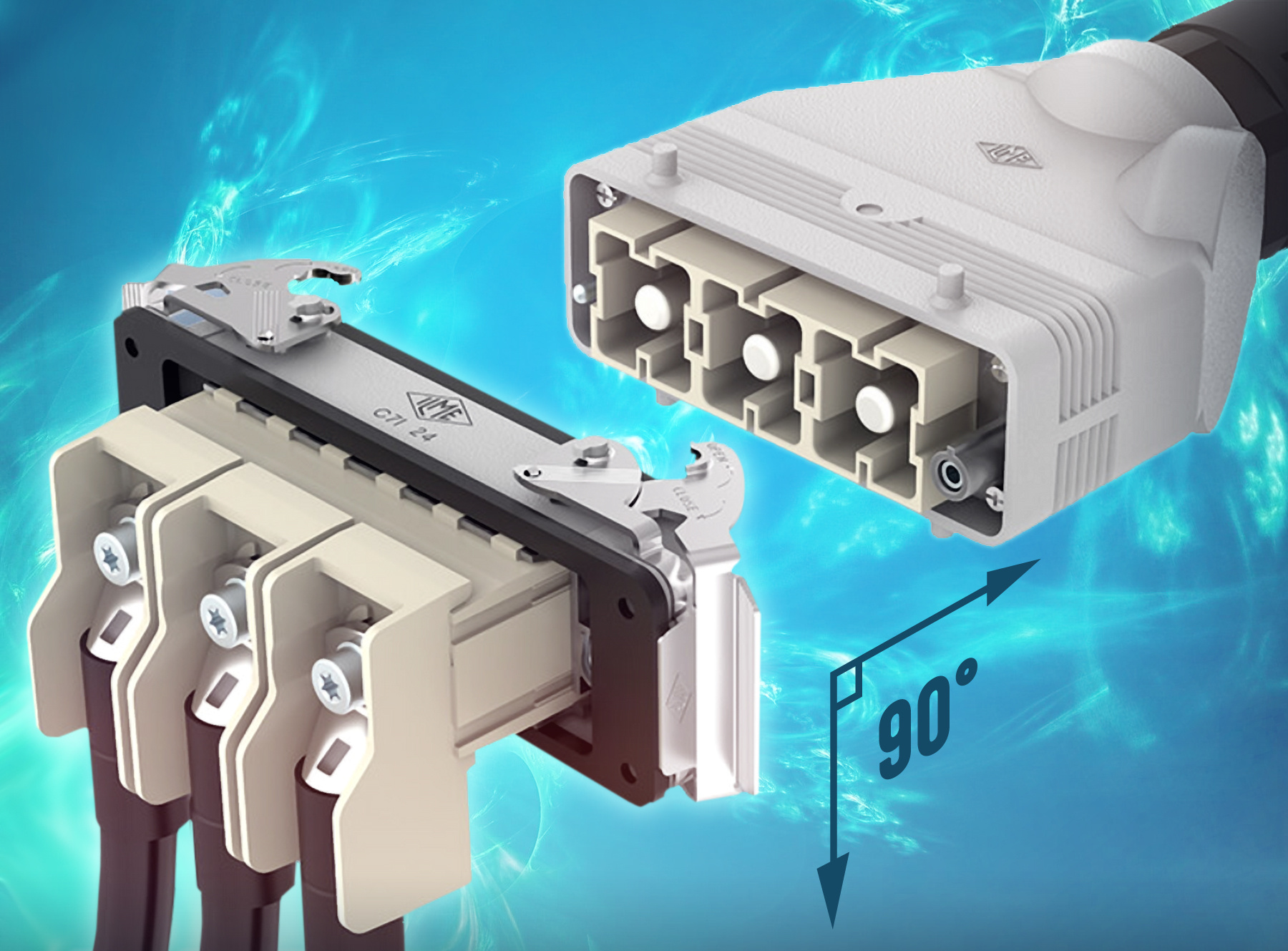

The MIXO right-angle high-current rectangular connector modules feature a 90-degree connection to minimize bending of large diameter wires.
Mencom Corp. has introduced the MIXO right-angle high-current rectangular connector modules, model name CX-01YA. The connectors have a compact 90-degree connection which helps to minimize installation space when integrating power systems and associated assemblies.
Key features include:
  • 90-degree connection removes bending of large diameter wires (up to 70 mm2)
  • ensures reliable 200A rating performance
  • special insulating cover plate prevents accidental contact between cable lugs on adjacent modules
  • compatible with standard bulkhead mounting housings.
Further Technical Details
According to Mencom, the special insulating cover plate included on the MIXO right-angle connectors offers multiple benefits. It can save the nominal voltage rating of 1000V planned for the 200A modules while connecting the DIN 46235 pre-insulated crimp cable lugs the company states in its press release announcing the launch of the connectors.
The connector's ability to eliminate bending of large wires due to its 90-degree connection will benefit use with high-power modules in the current range of 70-200A. Mencom notes these large wires can be difficult to handle because of how thick they are which reduces their bend radius, often causing floor space in a facility to be taken up. Not only does this clutter the space but it can also cause safety issues.
