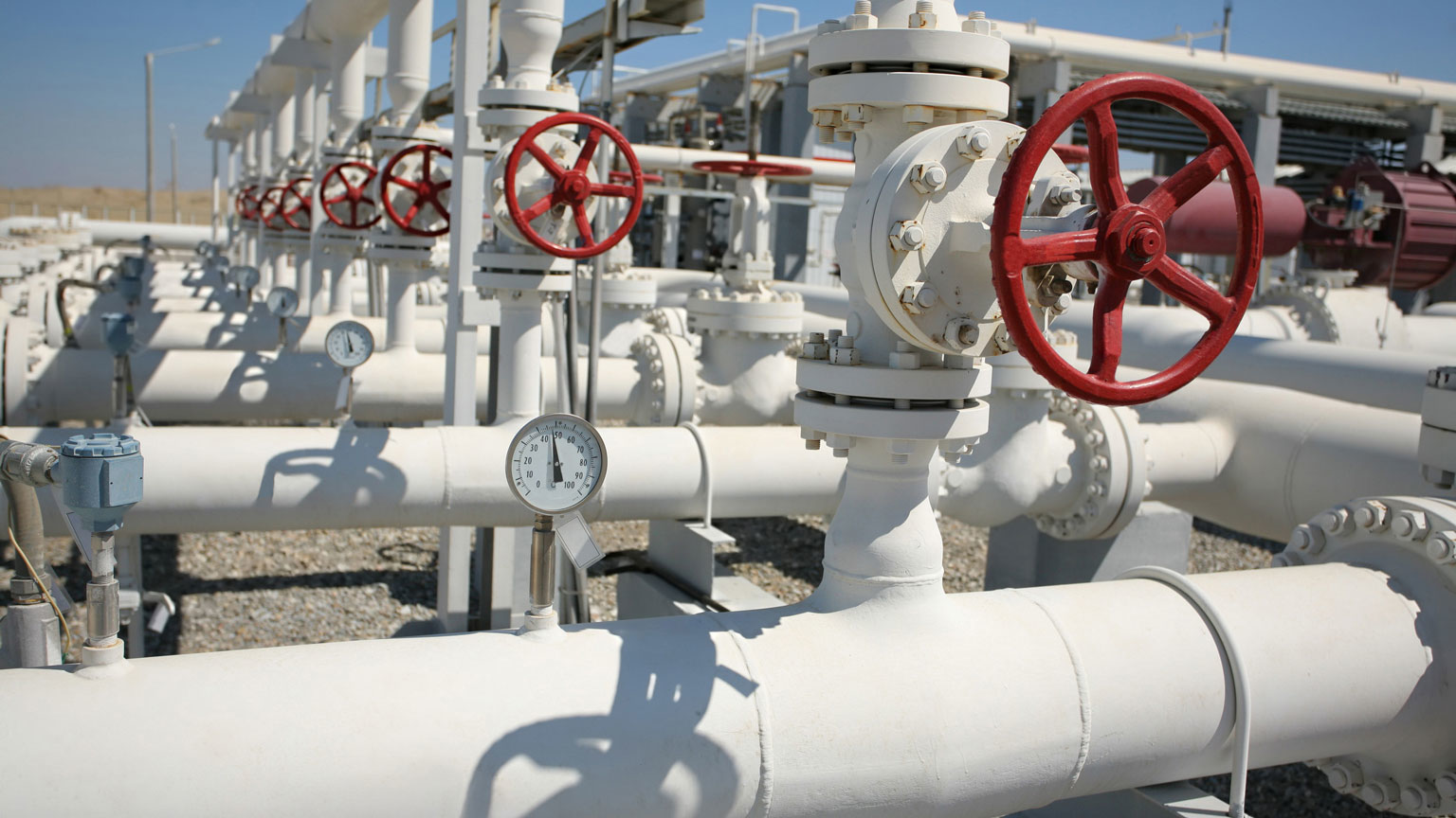

Effective industrial valves provide a reliable and durable fluid service, necessitating the appropriate product selection and maintenance for optimal performance.
Industrial valves are indispensable flow control devices that regulate, isolate, initiate, stop, and alter the direction of fluids. These devices can also relieve excess pressure from a piping system or from pressurized vessels. There are multiple valve designs and sizes to suit different industrial applications. Choosing or utilizing the wrong valve can affect the quality and consistency of industrial processes negatively. Engineers consider several process variables, fluid properties and environmental conditions when sizing and selecting valves.
Effective industrial valves should provide a reliable and durable fluid service — dispensing fluids at the required flow rates, sealing against leakages, backflows and emissions, and maintaining optimal sensitivity to pressure and temperature changes in the pipeline. Valve components should provide adequate physical and chemical resistance to corrosion by service fluids and immediate environments.
Understanding the operation of different categories of valves is beneficial for choosing and customizing flow control solutions for several industrial applications. How complex is the valve selection process, and what factors should engineers consider when selecting industrial valves to minimize their total cost of ownership?
