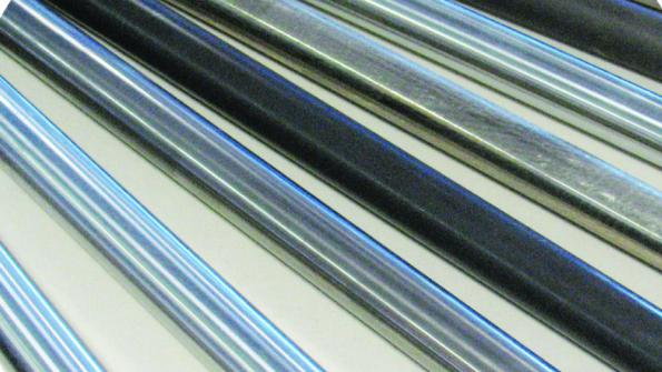

Platings and coatings
The surface roughness of hard-chrome plated piston rods progressively changes during the component’s life cycle. The surface typically becomes smoother over time, which prevents the surface from maintaining a thin film of lubricating oil. The result is higher friction against piston rod seals. Micro-cracks can also form, leading to abrasion of the chrome tips on the piston rod surface and the formation of longer score marks across the entire running surface. These changes have a negative impact on the entire tribological system and can lead to functional failure of the hydraulic equipment.
The demand for piston rod coatings that do not change their roughness and structure even after long service periods has led to the development of new techniques. Parker-Prädifa has extensively tested the effects of these alternative coverings on the performance of piston rod seals. The test results detailed on the next page, plus many other relevant tests, show that the treatment or coating of the piston rod surface has a significant impact on the friction, leakage, and wear behavior of piston rod seals.
In addition to delivering results that could certainly be described as positive, many alternative, initially seal-compatible piston rod coatings were found to exhibit increased seal wear with the resulting premature failure due to leakage after prolonged testing cycles.

Piston rods with the following types of coatings were tested in the Parker-Prädifa physical lab concerning their influence on friction, wear and leakage of piston rods:
• hard-chrome plated piston rods from various
   manufacturers with different degrees of roughness,
• hard-chrome plated piston rods with PTFE sur
   face treatment,
• ceramic coated piston rods with and without a
   sealing coat,
• salt-bath nitrided piston rods,
• plasma-nitrided piston rods (with and without additional grinding process),
• chemically-nickel coated piston rods,
• piston rods with melted compound coatings,
• nitrided and nitro-carburated piston rods, and
• HVOF spray coated piston rods.
