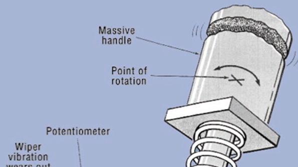

The two popular designs of displacement-type joysticks are potentiometric movement and inductive coupling. The potentiometric joystick, Figure 1, uses a rotary or linear potentiometer to convert mechanical displacement to electrical output. The conversion from curvilinear motion of the joystick lever to potentiometer movement usually involves shafts, gimbals, gears, and torsion springs. These mechanisms contain many parts, which can make these joysticks vulnerable to damage and shortened lifespan - especially if they are exposed to machine vibration.
Potentiometric joysticks are available in high-cycle-life construction with published life in excess of 106 full cycles. Most joysticks spend the greater part of their working lives in a neutral position, with the wipers of their pots being dithered continuously due to the vibration of the machinery onto which they are mounted and the mass of the control levers. This low amplitude cycling (dithering) of the pot wiper may prove more destructive to the pot than full-cycle stroking would. The constant dithering and high accumulation of cycles over a narrow area may cause the conductive element to wear-in locally, causing a "dead" or "noisy" spot.
