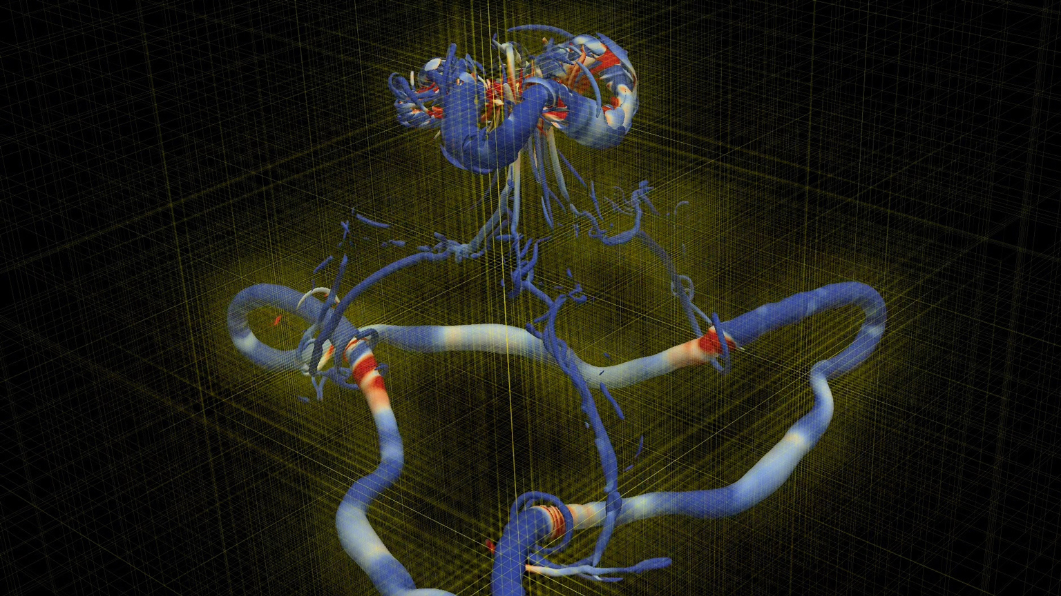

To help design aircraft that can better maneuver these extreme situations, Purdue University researchers have developed a modeling approach that simulates the entire process of a vortex collision in a reduced computational time. The data extracted from the simulation can then be used to help aircraft respond to these events.
With more realistic and complete simulations, engineers can design aircraft capable of more abrupt maneuvers or helicopters that can land more safely on aircraft carriers, the researchers said.
“Aircraft in extreme conditions cannot rely on simple modeling,” said Carlo Scalo, a Purdue associate professor of mechanical engineering, in a press release. “Just to troubleshoot some of these calculations can take running them on a thousand processors for a month. You need faster computation to do aircraft design.”
The model, which would still require a supercomputer to run, is called “Coherent-vorticity-Preserving (CvP) Large Eddy Simulation (LES).” The researchers applied the CvP-LES model to the collision events of two vortex tubes that are known to trail the wings of a plane and “dance” when they reconnect.
“When vortices collide, there’s a clash that creates a lot of turbulence,” said Scalo. “It’s very hard computationally to simulate because you have an intense localized event that happens between two structures that look pretty innocent and uneventful until they collide.”
Using the CvP LES model, engineers can simulate vortices over any length of time to best resemble what happens around an aircraft. Physicists could also shrink the model down for fluid dynamics experiments.
