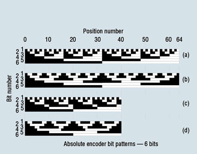

In continuing the discussion from last month, we now move on to explore absolute encoders. Figure 1 shows the window-shade arrangements for four different 6-bit absolute encoders. They are depicted as lying along a straight line, as in a linear motion encoder; however, they can also be generated in a rotational disc. The advantage of the absolute encoder is that it cannot “forget” where it is when power is turned off. The disadvantage is that they are more expensive than their incremental kin, and there is one channel for each bit, and one output wire for each bit, which accounts for their cost. The better the required resolution, the greater the number of bits. In fact, the resolution is given by:
R = 1/2N
where R is the encoder resolution and
N is the number of bits.
In Figure 1, all being 6-bit encoders, the smallest resolution is 1/64, meaning that the physical excursion can be resolved down to 1 part in 64. If it is a rotational system, the full circle could be broken into no smaller increment than 5.625° (360°/64). This is not a precise system. However, more bits in the figure would only serve to make the drawing more difficult to read.
Figure 1. Shade-window schematics for four different 6-bit absolute encoders: pure binary (a), gray code (b), pure BCD (c), and gray code BCD (d).
Referring to the encoder patterns in Figure 1, observe that the white/black (logical zero/one) pattern in any given vertical line drawn through any one of the 64 increments is unique compared to any other vertical line. That is, there is a unique one/zero bit pattern at each of the 64 positions. The reading device, probably a computer or a PLC, will be able to monitor the bit pattern and “know” where the encoder shaft is in position within the resolution. The resolution becomes finer as the number of bits increases, so the position can be determined with greater precision. This is true of all the encoders represented in Figure 1.
Gray code encoders
I must point out that there is a flaw in the pure binary encoder of Figure 1(a), and it involves the transitions from one increment to the next. In a pure binary configuration, for example, five bits change in going from the 32nd to the 33rd position. It is impossible to construct the window shade edges and then position the LED-phototransistor pairs so that all five transistors switch at exactly the same instant. As a result, ambiguity always exists in making the transitions from segment to segment. The gray code was invented to circumvent this problem.
The genius of this code is that there is only one bit that changes in moving from one segment to the next. But now it is a software problem to decode the bit pattern. The bit pattern is interpreted as a pure binary number, but then this number “points” to a location in a “look-up” table, which holds the true position value for the given bit pattern. It is not a difficult programming process.
Position data are available at all times (assuming power is on) immediately. So a computer, or other interrogating device, merely has to access the several parallel wires and read the bit pattern. That bit pattern is converted to the actual position, and orders then are issued to move forward, backward, or remain in the current position. All this is done in the computer with the control software.
