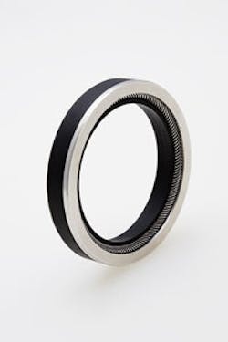

The LKS is a high-PV (pressure/velocity) seal from Bal Seal Engineering, Inc. It combines material and design technology to provide longer service life in tough oilfield applications.

The LKS seal uses graphite-reinforced PTFE, PEEK, a spring, and a ring to provide extended service life in high pressure, high velocity rotary applications.

One example of just such an innovative amalgam can be found in the LKS Seal, which debuted at last year’s Offshore Technology Conference in Houston. The seal, produced by Bal Seal Engineering, Inc., consists of a spring-energized, graphite-reinforced PTFE sealing ring coupled with a high-temperature engineered thermoplastic anti-extrusion element and a metal locking ring.
When you look at the LKS, it’s instantly apparent that each of the components has its own unique role to play: The metal locking ring prevents outer diameter of the seal from dynamic movement, minimizes friction/heat and prolongs seal service life. At moderate speeds, the graphite-reinforced sealing ring retains the ability to seal in high-temperature, high pressure service conditions while providing a high level of extrusion resistance due to its long-wearing properties and built-in lubricity. The thermoplastic anti-extrusion element minimizes seal jacket extrusion, provides longer sealing life, forces wear to occur at lip contact area (not the hinge point), and extends seal performance range at low and high temperatures (-94° to +550°F). And the Hastelloy Canted-coil spring exerts uniform sealing force against the shaft, reducing heat build-up and extending seal life while providing excellent corrosion resistance and chemical compatibility.
The LKS and other similar multi-component seals represent a novel take on problem-solving, because they deal in capabilities rather than limitations. Their design considers, for example, how the high-temperature behavior of PEEK (which becomes more flexible at 180°F) will complement the lubricity of PTFE, and how the force exerted by a spring can help the whole package provide longer service life. You might say it’s sealing from a holistic perspective.
