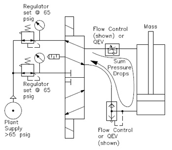

Too often,  flow coefficient, CV, is used to size a valve without giving consideration to the other components in a pneumatic circuit. In the past, a focus on the valve alone often sufficed because the cost of air was considered “free” and designers tended to significantly oversize the valve. Today’s emphasis on better energy management and optimized performance requires a more-exacting method to properly size pneumatic motion systems.
As shown in this pneumatic circuit, designers must account for pressure drop across the valves, but also for other system components such as fittings, flow controls, and tubing.
Using the following design process, sustainability conscious users will increase their “green footprint” by decreasing their air and energy usage with a corresponding drop in CO2 emissions. Reductions are realized by using smaller, fewer, and less expensive components. Debugging and rework time is minimized and the entire system runs more smoothly and efficiently. Finally, suggestions are offered to better optimize circuit designs.

To put these factors into practical terms, let’s look at the process involved in designing a typical system. Consider a pneumatic motion system initially consisting of:
  • A pneumatic air cylinder, rod up, pushing a 10-lb mass vertically 3 in. in 0.170 sec.
  • A non-lubricated supply pressure of 79.70 psia (65 psig) and an exhaust pressure of 14.70 psia.
  • A PLC with a scan time of 0.010 sec.
  • A valve shifting from closed to open in 0.032 sec for a valve with CV=1.
  • Prior to the valve shifting, a 79.70 psia pressure is holding the load down with the bottom of the piston fully exhausted. This pressure can differ from the supply pressure that lifts the cylinder.
  • 14-in. lengths of flexible tubing with no angled fittings connect the valve and cylinder.
  • No external friction sources exist.
  • No flow controls will be used.

Method: We’ll sum all the pressure drops around the circuit, starting at the valve exhaust port (atmospheric pressure) and ending at the valve supply port (regulated supply pressure). These pressure drops should add up to the pressure difference between the supply pressure and atmospheric pressure. This is very similar to Kirchhoff’s Voltage Law used by electrical engineers to solve electrical circuits.

Here are a few suggestions for optimizing your circuit designs:
  • Mount valves as close to actuators as possible to keep their air lines short.
  • Keep air lines between the valve and cylinder as straight as possible with minimal bends. Bends greater than 10x the air line ID do not appreciably affect performance.
  • Flexing air lines wear over time and can cause further restrictions.
  • Select cylinder bore sizes and strokes to handle the expected load plus a reasonable safety factor. Larger and longer-than-necessary cylinders cost more, waste space and energy, and add cycle time.
  • Consider using frictionless air cylinders such as those available from Airpot Corp. The first example required almost 2/3 of the cylinder’s force to overcome friction. Don’t forget to consider their increased leakage rate.
  • A valve can be oversized without appreciably wasting air. However, cycle time will increase if shift time increases.
  • A pair of 3/2 valves mounted directly in each cylinder port has several advantages. Speed should increase. Delay time will be reduced. There will be no pressure drops due to fittings, bends, air lines, and flow controls. Less air will be consumed because the air lines are not continuously being charged and discharged.
  • Over-pressurizing a circuit beyond a certain point — the maximum pressure drop — does not increase cylinder speed but does waste air and will increase delay time and total cycle time.
  • If the application calls for different loads or speeds for extend and retract motions, consider using pressure regulators or flow controls. Try downsizing an air line to slow down the motion and use less air.
  • Consider using quick-exhaust valves. The dumped air bypasses the exhaust circuit, reducing cycle time and increasing speed. Further savings are realized by adding regulators and lowering air consumption.
  • Each application has an optimum air-line ID. Increasing the air-line diameter increases CV but also increases the volume that must be charged and discharged each cycle.
  • Components with the smallest Cvs and the largest pressure drops limit circuit performance. Increase these Cvs first to have the greatest impact on circuit performance.
  • Components with the largest Cvs and smallest pressure drops are probably oversized. Decreasing these Cvs could improve circuit performance and reduce component costs.
  • Don’t forget your incoming air quality. Poor performance will eventually result from moist air, causing rust in your air lines and components. Oil residue may build up on interior surfaces due to lubricated air causing sticking and air line constrictions.
  • Plan on the machine operators adjusting pressure above design spec. to improve cycle time if necessary. This is often the first knob that gets turned to compensate for wear and corrosion over time.
  • If you determine the cylinders’ speed has become excessive, a shock absorber’s effect on stroke time can be estimated. The extra time a shock absorber adds to stop a load can be calculated by dividing the shock absorber’s working stroke by the cylinder’s speed when the shock’s initial contact is made. For example, adding a 1-in. stroke shock absorber to a 3-in. stroke cylinder with a contact speed of 40 in./sec would add roughly 1/40 second to the stroke or 0.025 sec.
  • Don’t be afraid to experiment — vary the numbers. You’ll probably learn more from circuits you didn’t use.
