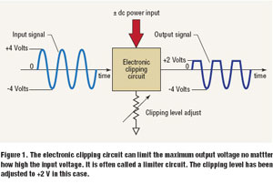

The black box approach can be facilitated with an example. In Figure 1, there is a specialized electronic circuit called a clipper, or clipping circuit. The function of a clipper is to limit the output to some predetermined or adjustable level no matter what the input level is. In the example, the input signal is a sine wave with a peak amplitude of 4 V and a minimum amplitude of 4 V. It is a continuous wave, even though only three complete input cycles are shown in the figure.
There is a number of things to be emphasized. First, the sine wave goes into the circuit at full plus and minus amplitudes, but the peak of the output voltage is limited to +2 V, which is exactly what the clipper was designed to do.
Second, the circuit is equipped with a clipping level adjust control, a potentiometer, or pot, so that the peak level of the output can be set by the user in the application. We don’t know the range of the adjustment, but it is reasonable to expect that the limit could be set anywhere between 0 V and +4 V, or even more. Also, we don’t know if the limit adjustment is itself limited to only positive levels, or, if it can adjust for some negative values, too. To determine such matters, we would need documentation from the circuit designer in the form of a users’ manual.

Fourth, the common point for the clipping circuit is drawn as a small downward pointing arrow just at the bottom of the clipping level adjust pot.
It must be emphasized that this is not mother Earth, merely the common point for the clipper and its power supply. Indeed, there may not be any connection to mother Earth at all. Your calculator has no mother Earth connection, but it does have an internal common, and, sadly, its designers probably refer to the point as “ground.” Be forewarned, electronic designers throw around the term ground, and the user has to be aware that real connections to mother Earth have serious implications when it comes to electronic noise. It may help the noise, or it may make it worse. We’ll talk more about that later.

Sixth, this circuit has practical value in electrohydraulics. It can be used to limit the amount of current and voltage that are sent to a proportional or servovalve. For example, single rod-end cylinders extend and retract at different speeds. By setting the clipping level, the user can limit the amount by which the valve spool is shifted, and by “tuning” the circuit, extend and retract speeds can be made the same. But, there is a little more explanation needed. That is, the clipping circuit will have to be designed so that both negative and positive values can be limited, so there is limit control for both directions of valve shift. The designer of such a circuit will most likely not call it a clipper — rather, it will be called a limiter, or some other user-friendly name. A practical valve stroke limiter is shown in Figure 2. Take note of the differences. There are now two level adjustments, one for each direction of spool shift. One has been adjusted to +2 V and the other to 3 V. In the proportional valve control circuit, the input would likely NOT be a sine wave, but rather just some arbitrary input or command voltage. But whatever the input, the maximum plus and minus values would be determined by the settings on the clipping level adjustments, also called the ± limit controls in Figure 2. In this example, the limits have been adjusted to +2 and 3 V respectively.
