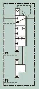

Hydraulic-over-air relay valve passes air pressure in proportion to a hydraulic pilot signal from a master cylinder, hydraulic control valve, or other component. The single input valve shown above (schematic symbol below) provides one hydraulic pilot port to control modulated air braking pressure.

A dual input valve uses two independent pilot ports to control modulated air braking pressure. The dual design functions the same as a single design when pilot pressure is applied to either the P1 or P2 port. When pilot pressure is applied to P1 and P2 ports at the same time, controlled air braking pressure ratio increases proportionally. The P1 and P2 ports can be of different pressure ratios.

If manufacturers do standardize on air brakes for trailers, a tractor’s hydraulic system could control trailer braking by using a hydraulic-to-air relay modulation valve. The valve works by sensing the incoming hydraulic pressure when an operator presses on the tractor’s brake pedal. This pressure is then converted to a regulated air pressure that is transmitted to the trailer’s air brake system. This allows a tractor’s compressed air system to modulate air pressure to the trailer.
The tandem input valve functions the same as the single design except it provides redundancy by having two independent pilot pressure ports. Hydraulic pilot pressure can be applied to the P1 and/or P2 port, and the pressure ratio remains the same.
