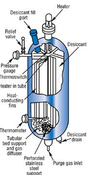

Regenerative desiccant dryers remove water from air by adsorbing it on the surface of a microscopically porous desiccant, usually silica gel, activated alumina, or molecular sieve. The desiccant does not react chemically with the water, so it need not be replenished. However, it must be dried, or regenerated, periodically.
Heatless regenerative dryers use two identical chambers filled with desiccant. As wet air moves up through one chamber, a portion of the dry discharged air is diverted through the second chamber at close to atmospheric pressure, reactivating its desiccant. The moisture-laden purge air is vented to atmosphere. Some time later, air flow through the chambers is reversed.
Standard industry dewpoint ratings for these dryers is -40° F at pressure. By adjusting the flow rates and volume of purge air, -100° F pressure dewpoints can be achieved. These dryers, as with all desiccant dryers, should be supplied with oil-free air. Oil will greatly reduce the life expectancy of the desiccant.
Heat regenerative dryers also use two identical chambers. In this type, however, air flows through one chamber until its desiccant has adsorbed all the moisture it can hold. Then air flow is diverted to the second chamber. Internal heating elements or an external source of heat (steam or electricity) then dries the saturated desiccant in the first chamber. Because desiccant's adsorption capacity decreases as temperature increases, the dried desiccant bed must be cooled from the temperature it reaches during regeneration before it can be used again. The regeneration cycle in these dryers usually lasts several hours - 75% heating and 25% cooling.
Regenerative desiccant dryers can produce pressure dew points as low as -100° F. The type of desiccant used has a definite effect on the final dew point.
