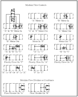

Fig. 13-21. Symbols for modular flow controls and flow dividers
Most flow control functions are available as modular or sandwich valves that mount between directional control valves and a subplate. Figure 13-21 shows most of the common configurations presently offered by fluid power suppliers. Although the symbols show non-compensated flow controls, most configurations also are available with pressure-compensated flow controls. Where a needle valve is shown, a flow control with bypass may actually be installed. This is not a problem because there is never a reason for flow reversal. Figure 13-21 also shows two modular flow dividers that are available from one supplier. These modules are usually available in all valve sizes up to D08 (¾-in. ports).
