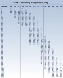

Sizing the piping system
As we work through sizing, we will refer frequently to Table 1. Many pressure drop charts are available. The reason for using this one is that you can calculate resistance to flow for any flow, pressure, atmospheric pressure, pipe size, or length. The formula to use with the table is as follows:
PL= (FŸLŸAŸP1)/(1000ŸP2)
where:
PL= pressure loss in psi,
F= the factor intersecting on the table with selected scfm rate of flow and pipe diameter
L= length of pipe, in feet, as determined for this specific calculation,
A= correction factor for valves and fittings (if you calculated each valve and fitting, it would take forever); a reasonable factor for adjusting these losses would be 1.2,
P1= atmospheric pressure in psia, and
P2= initial pressure to the pipe section you are calculating expressed as gauge pressure ` P1 in psia.
You can also use Table 1 when you measure the differential across a given pipe size and length and want to determine the flow associated with the differential.

When averaging in evaluating the cumulative demand, a process flow diagram should be used, Figure 1. (This is normally done in a tabular format). List the air-using equipment in flow per minute. Use factors are applied and the percentage established is moved to the right hand column. Then, the factored volumes are added up, regardless of pressure — this is called the demand. The total factored volume is then expressed at the highest single use pressure of all components. The supply compressors are sized on this basis. All of the system components are then sized based on the rate of flow of the compressors, including dryers, filters, and piping. A receiver or receivers are also included in the components selected. Storage tanks and piping will increase the rate of flow based on their volume per unit pressure capacitance and how much the designer plans on allowing the pressure to fluctuate.
The highest rate of flow of the system from both the supply and demand perspectives must be carefully determined, in order to achieve the desired pressures at the point of use with the lowest energy needed at the supply end of the system.
Let’s say the compressors are capable of 1000 cfm at 110 psig. The total system capacitance for piping and tanks is 45 ft3 per psi. If the pressure is allowed to fluctuate 10 psig, the downstream components would have to be sized for:
1000 cfm + [(45 cfm/psi)×10 psi] = 1,450 cfm
Thus, 1,450 cfm is the highest supply rate of flow. The calculations should be done progressively outward from the individual compressors, in a process flow format, tracking rate of flow and pressure.
