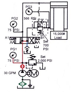

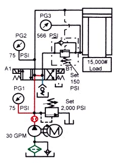

Figure 5-4 pictures a circuit with a running-away load. This circuit demonstrates the operation of an internally piloted counterbalance valve. The cylinder in Figure 5-4 has a static pressure of 566 psi in the rod end due to the 15,000-lb load on the 26.51- in.2 area. (15,000 / 26.51 = 566 psi). An open-center directional valve unloads the pump and keeps backpressure off the counterbalance valve outlet and pilot port. The cylinder holds in any position if the counterbalance valve is set correctly and does not leak. Set the counterbalance approximately 100 to 150 psi higher than the load-induced pressure.
Fig. 5-5: Internally piloted counterbalance valve with cylinder extending
Normal procedure for setting a counterbalance valve is to turn the adjusting screw to its highest pressure before raising the cylinder. After starting the pump, energize the directional valve and carefully raise the load a short distance. With the load suspended, deenergize the directional valve. A working counterbalance will hold the load suspended and gauge PG3 will show the load-induced pressure. Now start lowering the counterbalance pressure setting slowly. When the cylinder begins to creep downward, increase the pressure until creeping stops. Then continue turning the adjusting control in the same direction another to turn. After setting the counterbalance this way, power the cylinder down and notice the pressure reading on gauge PG3. Pressure should be approximately 700 to 750 psi. Any time the cylinder loading changes, repeat the above process. Resetting the counterbalance valve keeps the cylinder from running away and reduces energy loss with a lighter load.

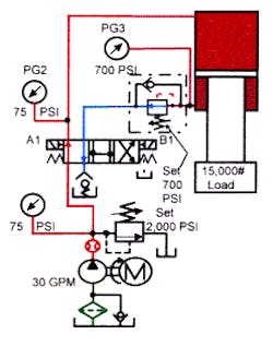

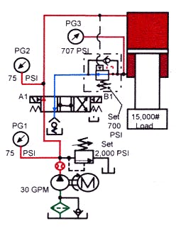

When the directional valve shifts to extend the cylinder in Figure 5-5, oil from the pump flows into the cap end of the cylinder and pressure starts to build. When pressure in the cap end of the cylinder reaches about 75 psi, the cylinder should start to stroke. (This is because it builds an extra 140 psi in the rod end, adding to the load’s 566 psi.) At this point the cylinder starts to extend and continues to move as long as the pump supplies oil at 75 psi or higher to the cylinder cap end. If pump flow changes, cylinder speed changes also.

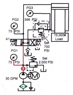

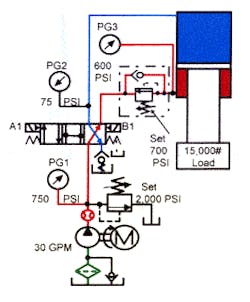

While the cylinder is retracting, Figure 5-6, pump flow bypasses the counterbalance valve through the integral bypass check. The counterbalance valve offsets the potential energy of the weight on the rod end of a cylinder. The 15,000-lb force in this figure cannot do useful work when using an internally piloted counterbalance valve. (See Figures 5-13 through 5-15 for energy loss and heat generation for different types of counterbalance circuits.)

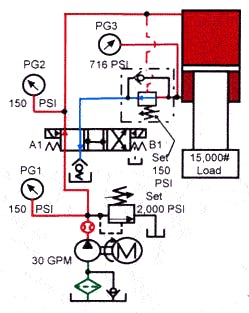

Figure 5-7 shows an externally piloted counterbalance valve circuit. (This is the same cylinder arrangement shown previously.) Notice the counterbalance setting of 150 psi with this circuit. Because this is an externally piloted counterbalance, it operates at a much lower setting. If the load changes, the counterbalance setting does not change. Load-induced pressure does not affect set pressure. Theoretically, set pressure could be 1 psi and the load would not move. The cylinder would only extend when the counterbalance valve’s external pilot port sensed 1 psi at the cylinder cap end.
On most externally piloted counterbalance valves, the minimum pressure setting is 100 to 200 psi. This keeps the counterbalance valve from hunting. Hunting starts when the valve sees enough pressure to open, but then opens too wide. The cylinder runs away when the valve opens too much and pilot pressure drops. When pilot pressure drops, the counterbalance valve closes and the cylinder stops. After the cylinder stops, pilot pressure builds again. The process repeats and continues to the end of stroke. The higher the load-induced pressure, the greater the hunting problem. (On some systems it is possible to add an orifice in the pilot line to slow the pilot supply response and reduce hunting. This orifice fix is difficult to get right and may cause other circuit problems.)

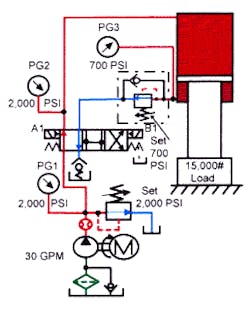

An internally piloted counterbalance valve controls cylinder extension smoothly, but reduces thrust during the working portion of the cycle.
Fig. 5-13: Internally piloted counterbalance valve with cylinder pressing

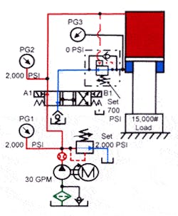

Figure 5-13 shows the maximum force from different types of counterbalance circuits while acting on a part with the cylinder stalled. System pressure of 2000 psi acting on the cylinder cap end produces 100,540 lb of thrust. (50.27 in.2 × 2,000 psi = 100,540 lb.) The 15,000-lb weight on the rod end increases the resulting downward force to 115,540 lb. The 716 psi acting against the 26.51-in.2 rod end area produces an upward acting force of 18,981 lb. (716 psi × 26.51 in.2 = 18,981 lb.) The net effective downward acting force is 96,559 lb. If the upward acting force could be reduced or eliminated, the cylinder could do more useful work.
The counterbalance valve more than cancels the weight of platen and tooling that gives an energy loss of approximately 16%. Approximately 7.5 tons of force from the rod end weight must be raised during every cycle but does not do any work as the cylinder extends.

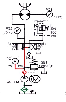

Excessive backpressure can damage a fast-turning hydraulic motor during an emergency stop situation. An open-center valve will eliminate backpressure, but the motor will continue to turn until it coasts to a stop. For a fast, non-shock stop, use a special counterbalance valve, called a brake valve. Figures 5-16, 5-17, and 5-18 illustrate a hydraulic motor circuit that uses a brake valve.
Fig. 5-16: Internally/externally piloted brake valve at rest with pump running
The brake valve is an internally/externally piloted valve with different pilot areas. Some designs take one eighth of the pilot pressure at the external pilot port as that set at the internal pilot port. This means, for example, that setting the internal pilot at 900 psi requires only 113 psi at the external pilot to open the valve. The actuator could be a hydraulic motor or a fast moving horizontally mounted cylinder with an over running load. In either case, a brake valve eliminates damage from stopping the actuator abruptly.

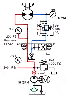

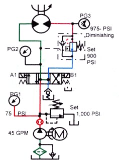

With the hydraulic motor moving, Figure 5-17, external pilot supply opens the brake valve at low pressure. As long as pressure required to move the motor is greater than the external pilot pressure needed, there is little or no energy loss. A brake valve appears virtually nonexistent as the motor runs under load. If the hydraulic motor tries to run away, say on a loaded winch, a brake valve holds against the load until the motors down port sees at least 113 psi. The load will lower only as fast as fluid enters the motor down port. A brake valve counterbalances when necessary and allows almost free flow under load.
Fig. 5-17: Internally/externally piloted brake valve with hydraulic motor running
NOTICE: Using a counterbalance or brake valve in a hydraulic motor circuit will not keep the motor from creeping when stopped. No matter how leak-free the counterbalance valve is, the internal bypass in the motor will let it slowly turn. Use an external braking system to hold any overrunning load driven by a hydraulic motor.
Fig. 5-18: Internally/externally piloted brake valve with hydraulic motor stopping
When the directional valve shifts back to its center position, Figure 5-18, external pilot pressure drops and the brake valve begins to close. The hydraulic motor now acts like a pump, trying to force oil through the brake valve. As the brake valve starts closing, internal pilot pressure builds to 900 psi, forcing fluid through the brake valve at a 900-psi pressure drop. This 900-psi backpressure decelerates the actuator smoothly and rapidly. Setting the valve pilot pressure higher makes the stop faster and more abrupt. A lower pilot pressure setting makes the stopping time longer but smoother. In any case, stopping action is smoother and quicker than it would be without the brake valve.
The difference between this circuit and a setup using a cross-port relief valve is that setting the brake valve at a pressure lower than system pressure does not affect normal actuator operation. Also, it eliminates the danger of cavitating an externally drained hydraulic motor. Note how the path around the brake valve with a bypass check valve allows reverse free flow for opposite rotation. To stop the motor quickly in the opposite direction of rotation, install another brake valve in the opposite motor line.
