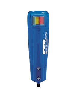

2. A moderately efficient coalescing filter such as the Balston Grade DX removes water condensed in the aftercooler and provides adequate prefiltration for refrigerant air dryers. Adding a second, high-efficiency coalescing filter ensures more thorough liquid removal.
Coalescing filters remove contaminants and help protect downstream dryers, which are sensitive to liquid contamination. At a minimum, a single-stage, high-efficiency coalescing filter rated at 93% efficiency at 0.01 μm is adequate prefiltration for refrigerant air dryers and general pneumatic equipment.
However, two-stage, high-efficiency coalescing filters ensure complete liquid removal, assuming no further cooling beyond the filter. When instrument-quality air is needed, or a desiccant air dryer is required, it is good practice to install a two-stage filtration system near the point of use. A two-stage system has a prefilter such as a Balston Grade DX (Fig. 2), that filters out larger droplets of water and oil and a polishing filter such as a Balston Grade BX, rated 99.99% at 0.01 μm, that filters out submicron-size droplets.

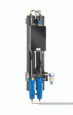

3. Desiccant air dryers pass compressed air through one tower to remove water vapor, while regenerating desiccant in the second tower.
Desiccant dryers deliver air at consistently low dewpoints, typically –40°F (–40°C) or less. The technology is a good choice when compressed air will be exposed to freezing conditions.
Desiccant dryers generally consist of twin towers of desiccant material that adsorbs water vapor (Fig. 3). Compressed air passes through one tower of desiccant until it’s saturated. Airflow then switches to the standby (dry) tower while the first bed is regenerated, driving captured water from the desiccant, with heat or a portion of dry air from the active tower. Heated and nonheated desiccant dryers serve the same purpose. They just use slightly different approaches.
Heated desiccant dryers require a great deal of electricity to operate. In contrast, heatless desiccant dryers don’t depend on electricity for drying, though they do consume and exhaust a small portion of the compressed air. In some cases, heatless desiccant dryers can be pneumatically controlled, which makes them suitable for explosion-proof installations.

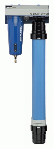

Membrane dryers offer a range of drying capabilities to about –40°F (–40°C) dewpoint. Like desiccant dryers, this suits them for sub-freezing environments.
Membrane dryers (Fig. 4) consist of bundles of hollow membrane fibers, each permeable only to water vapor. As compressed air passes through the center of these fibers, water vapor permeates the walls of the fiber, and dry air exits from the end of the membrane dryer. The module redirects a small portion of dry air (regeneration flow) along the outer surface of the membrane fibers to carry away the moisture-laden air, and it is released harmlessly to atmosphere.
3. Membrane air dryers like this Balston 76-20 produce compressed-air dewpoints to –40°F.
Membrane dryers have no moving parts and require no electricity, so they operate at a low cost. They only need their prefilter cartridge changed out, typically once a year. These dryers are ideal for critical end-use point applications, remote areas, and explosive environments.
