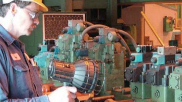

A mechanical inspector uses an ultraviolet light coupled with a fluorescent dye to uncover the root source of a hydraulic leak.

Dying to find the cause
Ultraviolet dyes are an effective tool for identifying individual leaks within a hydraulic system. They help to pinpoint active leaks in the presence of other oil and fluid films.
To properly use an ultraviolet dye test, follow these five steps:
  1. Add ultraviolet dye to the hydraulic reservoir as recommended by the dye supplier.
  2. Operate the machine normally to allow the dye to disperse throughout the system. It may be necessary to run several cycles at the end with metalworking coolants or other process fluids, which tend to wash the dyed oil away.
  3. Inspect the machine using a high-powered ultraviolet light for signs of the dye. Start in areas where leaked oil accumulates such as in drip trays, coolant systems, or basements. Once an accumulation is found, look for signs of oil flowing or dripping into the accumulation. The ultraviolet dye will illuminate oil along a path or stream. Trace this path back to its source.
  4. System consumption may be the result of one or many leaks. Quantify the rate of each find and compare the total against system consumption. Rates may vary with pressure, so observe the leak throughout the machine cycle if safely possible. Search until the number of leaks found accounts for the system consumption rate.
