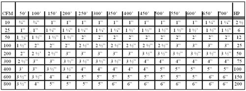

Fig. 3-1. Pipe size selection chart (in feet) for plant-air systems
Pipe materials and size: Air systems are normally plumbed with Schedule 40 black iron pipe. (Galvanized pipe is not recommended because some galvanizing material may flake off and get into moving parts.) Several other available plumbing materials could be used for air piping because pressure is relatively low. Some mechanics recommend plastic pipe, but be aware a few synthetic compressor lubricants attack plastic and cause it to lose strength. This type of damage weakens the plastic until it can burst, sending shards of plastic flying everywhere in the plant. Never use any piping material not specifically designated by code.
To help select pipe size, the chart in Figure 3-1 shows flow (in cfm) down the left-hand side, length of run (in feet) across the top, and minimum Schedule 40 pipe size in the body at the intersection of these two.
This chart is based on a 1-psi pressure drop for the run lengths given. The right-hand column shows approximate compressor horsepower for the flow figures on the left. Using larger than specified pipe is of little help in reducing pressure drop, but provides more storage volume to handle short brief-flow needs. This chart does not consider fittings and valves, but they also must be considered when figuring the length of a run. Add 5 to 7 ft of pipe length for each fitting or valve — to be on the safe side.
Not having enough air to run the equipment is expensive, so never try to save a few cents at installation by skimping on pipe size. One or two pipe sizes over minimum add little to cost up front, but can make a big difference later. It is less expensive to run oversize pipe initially than to have to add a line later.
