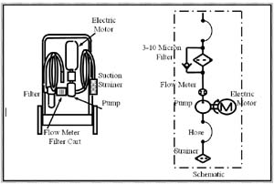

Fig. 2-1. Filter cart (used to transfer hydraulic fluids) and its circuit schematic diagram
New oil or other fluids from the supplier are not necessarily clean. The fluids are shipped in drums or by bulk, and there is no way of knowing how clean these containers are. Some suppliers offer filtered oil with a guaranteed contamination level at added cost. Otherwise, about the lowest level of contamination from most manufacturers is 25 microns.
Anytime a system needs new fluid, it is best to use a transfer unit, Figure 2-1, with a 10-micron or finer filter in the loop. Another way of filtering new or refill fluid is with a filter permanently attached to the reservoir, Figure 2-2. In this arrangement, the breather or other possible fill points should be made inaccessible.
Fig. 2-2 Hydraulic power unit and circuit diagram of its filter arrangement
The filter cart shown in Figure 2-1 can also be used to filter any hydraulic unit in the plant. Instead of this filter unit sitting idle except when filling systems, set it up at a machines power unit for a timed run. Place the suction hose in one end of the reservoir and the return hose in the opposite end. This adds a continual filtration loop to any machine even when the machines main pump is shut off. Run the cart until the fluid is clean and then move is to another power unit. Repeating this process on a regular schedule can assist the hydraulic units filters and add extra life to the fluid and the hydraulic components. This process may also show a pattern on machines that have a contamination problem.
