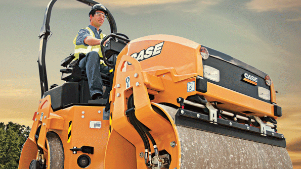

Innovative design of CASE Construction Equipment’s small double-drum vibratory rollers helps make short work of projects in tight spaces.
The CASE line of small double-drum asphalt rollers is ideal for parking lots, bike paths, tennis courts, and other small-to medium-size projects. CASE engineers designed each of four sizes (DV23, DV26, DV36, and DV45) to deliver the same level of productivity as its larger models, while helping to boost efficiency on jobs where space is tight, so maneuverability is paramount.
The CASE DV Series of small double-drum rollers from CNH America LLC, uses hydraulics for virtually every aspect of its operation. A pair of hydraulic motors drives each drum for maximum traction and another pair drives an eccentric weight in each drum for controller compaction. Articulated steering is provided via hydraulic cylinder.
Although compact, the small rollers incorporate design features normally found only on heavier machines — dual-vibration amplitudes, dual frequencies, and dual centrifugal forces. In addition, the smaller models are designed with hydrostatic drive and dual-drum drive systems. The rollers can handle anything from course base compaction to hot-mix asphalt. Operating weight for the rollers ranges from 4,960 lb (2,250 kg) to 10,296 lb (4,670 kg).
At first glance, an asphalt roller may seem to compact and flatten surfaces simply by its sheer weight. But spinning an eccentric weight inside the drum creates radial reaction forces that give the drum more compaction force than from gravity alone. The action is similar to compacting earth with your feet. If you stand still or walk, the earth is compacted simply by your weight. But if you jump up and down, the additional force when your feet hit the ground will compress the soil more than by simply standing on it.

The small DV Series rollers are suitable for virtually any situation where maneuverability and finesse is a must. The rollers feature a tapered offset drum and high curb clearance, allowing operators to compact right up to high curbs or other tight areas without having to worry about making marks or cutting the pavement.
Each roller also provides a tight turning radius for its size — as small as 93 in. (2,350 mm). The tight turning radius improves compaction times, and offset tapered drums reduce asphalt tearing while compacting around curves.
Steering is provided by an articulated joint that is controlled by a hydraulic cylinder. A maintenance-free Teflon bearing on articulated joint eliminates the need for greasing.
