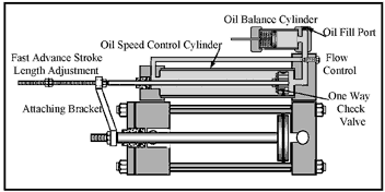

Attached oil-control cylinders
Some manufacturers offer attached oil-filled cylinders to control speed and/or position, Figure 17-1. These units usually work in one direction of travel in a meter-out circuit. They operate such things as drill feeds or other actions that may try to pull the cylinder out. (They also can be used with hydraulic cylinders at higher forces.)
Fig. 17-1. Hydraulically controlled air cylinder – set up for fast advance, controlled feed stroke, and fast retraction
Most manufacturers offer units with valves in the oil line that can stop flow and/or bypass the speed control. The stop control allows an air cylinder to be stopped reasonably accurately with very good repeatability. The bypass control makes it possible to have fast and controlled speeds as the cylinder advances.
The cross-sectional view in Figure 17-1 shows an air cylinder that advances rapidly with airflow controls until its attaching bracket comes in contact with the fast-advance stroke-length adjustment. At this point, air cylinder movement is retarded and controlled by the oil speed-control cylinder as oil flows through a flow control. The air cylinder cannot move any faster than the oil flow allows during this part of the cycle. A spring-loaded oil balance cylinder furnishes oil to make up for the differential loss from rod to cap ends. The air cylinder is controlled by oil flow for the remainder of the cycle.
As the air cylinder retracts and the attaching bracket contacts the rod nut, it pushes the oil speed-control cylinder back to the start position. A flapper-type 1-way check valve on the piston with through holes allows fluid to transfer back to the rod end. Excess cap end fluid is stored in the spring-loaded oil balance cylinder during this part of the cycle.
Some manufacturers offer attached units that are capable of control in both directions of travel. There also are self-contained air powered cylinders with built in oil cylinders and reservoirs. Air produces thrust while oil controls speed and/or mid-stroke stop-and-hold. Some units also have two-speed capabilities. These units look like a standard cylinder with an oversize rod.
