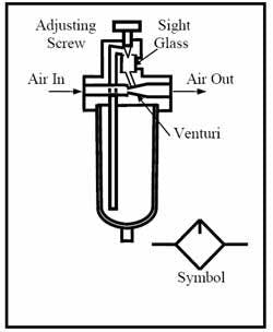

Figure 7-3 shows a cutaway view of an air-line lubricator. After the combination unit filters and regulates air pressure, some downstream system components may require a small amount of lubrication. (For example: air motors are one item that needs a constant supply of oil to extend their life and maintain torque.) Some cylinders are pre-lubed and most valves require little if any lubrication, so keep oil supply to these units at minimum. A general rule: a ½-pint bowl of oil in a lubricator should last three weeks to a month in most situations.
7-3. Cross-section of typical air-line lubricator, with ISO symbol.
When air passes through the lubricator’s venturi section, pressure drop across it gives a negative pressure in the area below the adjustable orifice. Vacuum in this area draws oil from the bowl as fast as the adjustable orifice will allow. These droplets then mix with the air as it passes through. This arrangement means that oil flows only when there is air flow and only as fast as the adjusting screw allows.
Air line lubricators are designed to send a mist of oil to the parts in the downstream circuit. However, the physical size of some circuits makes it impossible for the mist to stay in suspension long enough to reach some parts. In this case -- and for some air motor applications -- it is necessary to inject oil at the components inlet. There are electric and air-driven lubrication units to meet the needs of these applications.

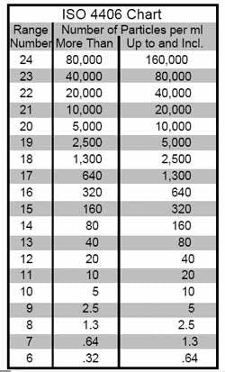

ISO has set up cleanliness level standards for hydraulic and lubrication fluids. The system most used for hydraulics is based on the ISO 4406 standard. This standard covers the number of particles of a given size that can be present in a fluid sample in three different micron ranges. It is designated ISO Code XXX/XXX/XXX, where the numbers relate to the minimum and maximum number of particles of a given size that can be present in a 100 milliliter sample. The first number indicates how many particles of 2-µ size can be present; the second number is for 5-µ particles; and the third number is for 15-µ particles. It might be written ISO Code 18/16/13. The numerals always descend in value from left to right. This code would mean that there could be between 1300 and 2500 particles of 2-µ size, 320 to 640 particles of 5-µ size, and 40 to 80 particles of 25 µ.
Figure 7-7 indicates that, even with good eyesight, people cannot see a particle smaller than 40µ. Thus it is impossible to look at a sample of fluid and determine whether it is clean. Of course, it is possible to tell it is contaminated when large particles are plainly visible in the sample.
The ISO 4406 chart shows the range number and the number of particles that it represents. From this chart it is easy to set up or pick out any ISO Code cleanliness level.
Some typical fluid cleanliness level ISO Code’s are shown in the following chart:
