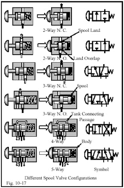

For circuits with flows less than 100 gpm, the most common hydraulic directional control valves use a spool-like internal member to direct flow. (Many air valves also use a spool, due to the advantages offered by this design.) The cutaway views in Figure 10-17 show some simplified spool arrangements and terms associated with this valve. Notice that counting the number of ports that carry working fluid on the cutaway or symbol gives the number of ways the valve has. A 2-ported valve is a 2-way valve and a 5-ported valve is a 5-way valve.
All valves in Figure 10-17 are two position as shown by two boxes in the symbol. As stated before, a 2-way valve can have only two positions because it can only stop or allow flow. All other valves are able to have three positions, while 4-way valves can have four positions in special cases. A 5-way valve is a special case mainly used in pneumatic applications where an extra exhaust port is not a problem. Notice that a 4-way valve has five ports but its tank ports are internally connected to eliminate an extra port in the body. This is important in hydraulic valves because it reduces piping and potential leak points.
Fig. 10-17. Views of a variety of valve spool configurations, with their symbols. (All have palm-button operators.)
