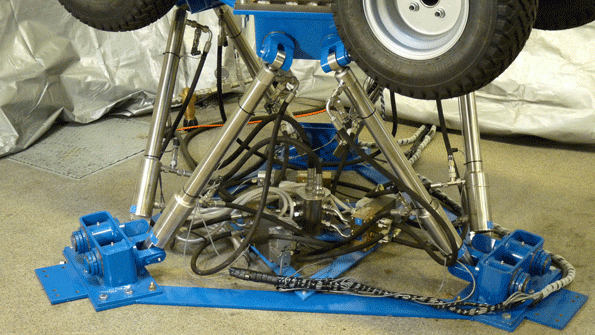

This water-hydraulic motion base provides six axes of proportional motion uses stainless-steel cylinders, fittings, and other components to resist corrosion, wear, and leakage.
