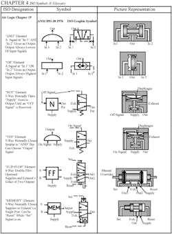

Analog - Of or pertaining to the general class of fluidic devices or circuits whose output varies as a continuous function of its input.
AND device - A control device that has its output in the logical 1 state if and only if all the control signals assume the logical 1 state.

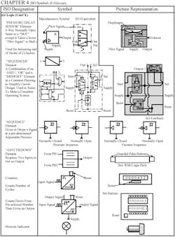

Circuit, sequence - A circuit that establishes the order in which two or more phases of a circuit occur.

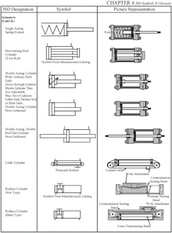

Cylinder - A device that converts fluid power into linear mechanical force and motion. It usually consists of a movable element such as a piston and piston rod, plunger or ram, operating within a cylindrical bore.
Cylinder, adjustable stroke - A cylinder equipped with adjustable stops at one or both ends to limit piston travel.
Cylinder, area, piston, effective - The area upon which fluid pressure acts to provide a mechanical force.
Cylinder, area, piston rod - The cross-sectional area of the piston rod.
Cylinder, bore - The internal diameter of the cylinder body.
Cylinder cap - An end closure for a cylinder that completely covers the bore area.
Cylinder capacity - The volume of a theoretically incompressible fluid that would be displaced by the piston during a complete stroke. (For double-acting cylinders it must be given for both directions of stroke.)
Cylinder capacity, extending - The volume required for one full extension of a cylinder.
Cylinder capacity, retracting - Volume (annular) absorbed by one full retraction of the cylinder oscillation of an output shaft.
Cylinder, cushioned - A cylinder with a piston-assembly deceleration device at one or both ends of the stroke.
Cylinder, differential - A double-acting cylinder in which the ratio of the area of the bore to the annular area between the bore and the piston rod is significant in circuit function.
Cylinder, double-acting - A cylinder in which fluid force can be applied to the moveable element (piston) in either direction.
Cylinder, double rod - A cylinder with a single piston and a piston rod extending from each end.
Cylinder, dual stroke - A cylinder combination that provides two working strokes.
Cylinder, duplex - A unit comprised of two cylinders with independent control, mechanically connected on a common axis to provide three or four positions depending on the method of application.
Cylinder force, theoretical - The pressure multiplied by the effective piston area (ignoring friction). For double-acting cylinders, the value must be given for both directions of stroke.
Cylinder, piston-type - A cylinder in which the piston has a greater cross-sectional area than the piston rod.
Cylinder, plunger (ram) - A cylinder in which the piston has the same cross-sectional area as the piston rod.
Cylinder, rotating - A cylinder in which the piston and piston rod, plunger or ram, is permitted to rotate with reference to the cylinder housing.
Cylinder, single-acting - A cylinder in which the fluid force can be applied to the movable element in only one direction.

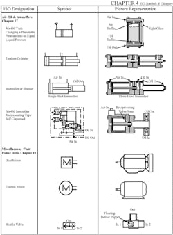

Cylinder, tandem - An arrangement of at least two pistons on the same rod moving in separate chambers on the same cylinder body allowing the compounding of force on the piston rod.
Cylinder, telescoping - A cylinder with two or more stages or extensions, achieved by hollow piston rods sliding one within the other (may be single- or double-acting).
Cylinder, tie rod - A cylinder with head and cap end closures that are secured by tie rods.
Cylinder, rotary actuator - A cylinder that translates piston reciprocation into oscillation of an output shaft.

Digital - Of or pertaining to the general class of fluidic devices or circuits whose output varies in discrete steps (i.e., pulses or "on-off" characteristics).
