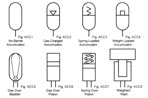

Hydraulic accumulators make it possible to store useable volumes of non-compressible fluid under pressure. A 5-gal container completely full of oil at 2000 psi will only discharge a few cubic inches of fluid before pressure drops to 0 psi. The same container filled with half oil and half nitrogen gas would discharge over 1½ gal of fluid before pressure dropped to 1000 psi.
Figures 1-1 through 1-4 show symbols used for different types of accumulators. Figures 1-5 through 1-8 are simplified cutaways showing construction of different types of accumulators.
Fig. 1-1 to 1-8. All accumulators except the weight-loaded version will undergo a pressure decrease as fluid discharges. A weight-loaded accumulator maintains pressure until all fluid is expelled. Click on image for larger view.
When using an accumulator, it is necessary to install a manual or automatic function to de-pressurize all fluid before working on the circuit. Several manufacturers make automatic discharge valves that work well. These automatic discharge valves are explained at the end of this section.

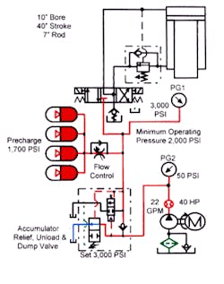

Accumulator circuits normally have flow controls because there is a volume of oil at elevated pressure that can discharge almost instantaneously. Placing a flow control at the accumulator outlet allows free flow from pump to accumulator and adjustable flow to system.
Figure 1-10. Click on image for larger view.
The circuit in Figure 1-10 has a minimum pressure of 2000 psi and a maximum pressure of 3000 psi. This pressure is the limit of most hydraulic components. A 22-gpm pump driven by a 40-hp motor now meets the force and cycle time specified. All pump flow continuously goes to the circuit instead of being unloaded most of the time as in conventional circuits.
As the cylinder cycles, the accumulators supply fluid at a rate set by the flow control. Pump flow adds to accumulator flow to set the required cycle time. Cylinder cycling could be made faster than specified by increasing outlet flow from the accumulator.
The fixed-volume pump in Figure 1-10 unloads through a special accumulator relief/unload/dump valve, which sends all pump flow to the accumulators and cylinder until the system reaches set pressure. After reaching set pressure, the valve opens and unloads the pump to tank at approximately 50 psi. The pump will continue to unload until the system pressure drops about 15%. This pressure drop might be from leakage or at the start of a new cycle. Any time pressure drops, the pump will load and stay loaded until pressure tries to go above 3000 psi. With this valve, stored oil in the accumulators automatically discharges to tank when the pump stops, which makes the circuit safe to work on shortly after locking and tagging off the pump.

To have a safe accumulator circuit, it is necessary to have a means to discharge stored energy at shutdown. The circuit in Figure 1-15 uses a high-ratio pilot-to-close check valve. The pilot ratio is about 200:1, which means 25 psi in the pilot line can hold as much as 5000 psi in the circuit. Most unloading circuits have at least 25 psi while unloaded, so this valve works well. When the pump shuts off, pressure drops to zero, the pilot-to-close check valve opens, and stored energy dumps to tank.
Another way to automatically discharge the accumulator at shutdown is with a normally open, solenoid-operated, 2-way directional valve. This directional valve connects to the accumulator pressure line and on to tank. Starting the pump motor also energizes the solenoid on the normally open 2-way valve, causing it to close. As long as the pump runs, this valve blocks the flow path to tank. When the pump stops, the solenoid is deenergized, and the valve shifts to port stored energy to tank.
CAUTION! ALWAYS CHECK AN ACCUMULATOR CIRCUIT FOR PRESSURE BEFORE WORKING ON IT. NEVER ASSUME THE AUTOMATIC UNLOADING SYSTEM WORKED!
