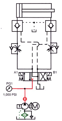

Figure 8-44 shows a tandem center valve. A tandem center valve lets the pump unload while blocking the cylinder ports. The cylinder sits still unless there is an outside force trying to move it. Any metal-to-metal fit spool valve never fully blocks flow. With external forces working on the cylinder, it may slowly creep with the valve centered. This is another common center condition for fixed volume pumps.
Figure 8-44. Tandem center condition.

Figure 8-49 shows an all ports blocked center condition, solenoid pilot-operated valve, as a simplified and complete symbol. On most schematics, the simplified symbol is sufficient. The solenoid slash and energy triangle in the operator box show the valve has a solenoid operated valve piloting a pilot-operated valve.
Figure 8-47. Open crossover or transition condition.
Figure 8-48. Closed crossover or transition condition.
The boxes show the function of the main or working spool that controls the actuator. On valves with other hardware added (here, pilot chokes and stroke limiters), it is better to show the complete symbol. Both symbols in Figure 8-49 represent the same valve. The complete symbol gives more information about the valve function and helps with troubleshooting and valve replacement.
Figure 8-49. Solenoid pilot-operated valve with pilot chokes and stroke limiters. Internal pilot supply (X) and external drain (Y).

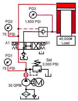

Figures 8-54 to 8-61 show another reason for using dual pressure inlets. They depict air cylinder movement with conventional hookup. The cylinder pauses before raising and drops rapidly when starting to retract.
Dual-pressure 5-way valves for air cylinder actuation

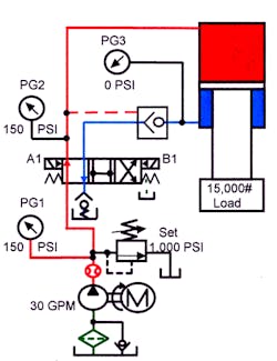

A vertical, up-acting air cylinder, with a heavy load, gives sluggish and jerky operation when valved conventionally. Figure 8-54 shows a conventional 5-way valve hook up on a cylinder raising a 600-lb load. This figure shows weight, cap and head end areas, and pressures at both cylinder ports.
Figure 8-54. Cylinder at rest.

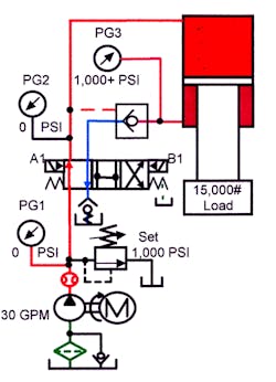

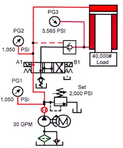

When the directional valve shifts, as seen in Figure 8-55, there is a pause before the cylinder extends. The weight-to-cylinder force ratio and the rate of cylinder travel speed control the length of pause. The heavier the weight and the slower the cylinder speed, the longer the pause. The delay could be three to four seconds in extreme cases.
The pause comes from weight pushing down along with force from air pressure on the cylinder rod end. At the moment the valve shifts to extend the cylinder, down forces are up to 1240-lb while up force is only 800 lb. As long as down forces exceed up force, the cylinder will not move. The slower the air exhausts, the longer it takes to get enough differential pressure across the cylinder piston to move it. The speed of exhausting air controls how fast the cylinder moves once it starts.
Figure 8-55. Valve just shifted, cylinder pauses.

The circuit in Figure 8-70 shows a horizontally mounted, non-leaking cylinder, positively locked in place any time the directional centers. When using an on-off type solenoid valve, a fast moving cylinder stops abruptly when the directional valve centers. Use a proportional valve with ramp timers to decelerate the actuator and eliminate shock damage.
Figure 8-70. Pilot-operated check circuit at rest with pump running.
Notice the directional valve has A and B ports open to tank in the center condition. This center condition allows pilot pressure to drop and the pilot-operated check valves to close. Using a directional valve with blocked A and B ports in center condition, may keep the pilot-operated check valves open and allow cylinder creep. If it is only necessary to keep the cylinder from moving in one direction, one pilot-operated check valve will suffice.

Figure 8-73 shows how using a pilot-operated check valve to keep a heavy platen from drifting can cause problems.
Figure 8-73. Pilot-operated check valve on running away load, at rest, pump running.
When a cylinder has a load, trying to extend it causes load-induced pressure. In the example cited, a 15,000-lb platen pulling against a 26.51 square inch rod end area gives a 566 psi load-induced pressure. This load-induced pressure holds against the poppet in the pilot-operated check valve, forcing it closed. The pilot piston must have sufficient pressure to open the poppet with 566 psi pushing against it. The pilot piston on most pilot-operated check valves has an area that is three to four times that of the poppet. This means it will take approximately 141-188 psi at the cap end cylinder port to open the poppet for reverse flow.
When the directional valve shifts, starting the cylinder forward, as shown in Figure 8-74, pressure in the cap end cylinder port starts climbing to 150 psi. At about 150 psi the poppet in the pilot-operated check valve opens and allows oil from the cylinder rod end a free flow path to tank. The cylinder immediately runs away, pressure in cylinder cap port drops, the pilot-operated check valve closes fast and hard, and the cylinder stops abruptly. When the pilot-operated check valve closes, pressure at the cap end cylinder port again builds to 150 psi, opening the check valve, and the process starts again. A cylinder with these conditions falls and stops all the way to the work unless it meets enough resistance to keep it from running away.
Figure 8-74. Pilot-operated check valve on running away load, cylinder extending, free fall.
With this circuit, system shock very quickly damages piping, cylinders, and valves.

Figures 8-76 and 8-78 show another possible problem using a pilot-operated check valve to keep a vertical down-acting cylinder from drifting. The cylinder in this example has a heavy weight pulling against the rod side. A load induced pressure of 1508 psi plus 142 psi from pilot pressure acts against the poppet in the pilot-operated check valve. This requires a high pilot pressure to open the pilot-operated check valve.
Figure 8-76. Pilot-operated check valve on running away load, cylinder just starting to extend.
It requires approximately 500 psi pilot pressure to open the pilot-operated check valve with 1650 psi against the poppet. As pilot pressure builds to open the poppet, it also pushes against the full piston area of the cylinder. This cylinder has nearly twice the area on the cap side as the rod side, so every 100 psi on the cap side gives about 200 psi on the rod side. As pilot pressure builds to the 500 psi required, pressure against the poppet in the pilot-operated check valve increases at twice the rate. Figure 8-77 shows the start of this condition.

In Figure 8-77, the cylinder rod end pressure is at 300 psi, which adds 570 psi to the 1508 psi load-induced pressure. The extra hydraulic pressure pushes harder against the pilot-operated check valve poppet, making pilot pressure increase even more.
As pilot pressure increases, down force and rod end pressure escalates also. In Figure 8-78, rod end pressure is at 3565 psi because pilot pressure continues to climb. In the situation shown here, it is obvious the relief valve will open before reaching a pilot pressure high enough to open the pilot-operated check valve. Even if pilot pressure could go high enough to open the pilot-operated check valve, the cylinder runs away and stops.
Figure 8-78. Pilot-operated check valve on running away load, cylinder still trying to extend.
