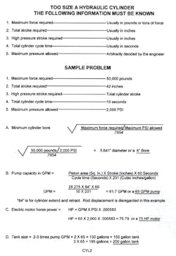

Sizing hydraulic cylinders
Chart 6-1 provides an exercise in sizing a simple, single-cylinder hydraulic circuit with straightforward parameters. The example covers the basic requirements for sizing a hydraulic cylinder to power a specific machine.
Of course, in the real world of circuit design, experience, knowing the process, the environment, the skill of the user, how long will the machine be in service, and other items will affect cylinder and power unit choices.
Before designing any cylinder circuit it is necessary to know several things. The first is the required force. Usually, the force to do the work is figured with a formula. In instances where there is no known mathematical way to calculate force, use a mock-up part on a shop press or on a prototype machine to estimate the force requirements. If all else fails, an educated guess may suffice. (The sample problem in the chart requires a force of 50,000 Llb.)
The second requirement is the total cylinder stroke. Stroke length is part of machine function, but it is needed to figure pump size. Use a stroke of 42 in. in this problem.
Third, how much of the stroke requires full tonnage? If only a small portion of the stroke needs full force, a hi-lo pump circuit and/or a regeneration circuit could reduce first cost and operating cost. This cylinder requires full tonnage for the complete 42-in. stroke.
Fourth, what is the total cylinder cycle time? Make sure the time used is only for cycling the cylinder. While load, unload, and dwell are part of the overall cycle time, they should not be included in the cylinder cycle time when figuring pump flow. Use a cylinder cycle time of 10 seconds for this problem.
Finally, choose maximum system pressure. This is often a matter of preference of the circuit designer. Standard hydraulic components operate at 3000 psi maximum, so choose a system pressure at or below this pressure. If the company that will operate the machine has operating and maximum pressure specifications, adhere to them. Remember that lower working pressures require larger pumps and valves at high flow to get the desired speed.
In the example in Chart 6-1, the square root of the maximum thrust, divided by the maximum system pressure, divided by 0.7854 gives a minimum cylinder bore of 5.641 in. Obviously, a standard 6-in. bore cylinder should suit this system.
To figure pump capacity, take the cylinder piston area in square inches, times the cylinder stroke in inches, times 60 seconds, divided by the cycle time in seconds, times 231 cubic inches per gallon. This indicates a minimum pump flow of 61.7 gpm. A 65-gpm pump is the closest standard flow available. Never undersize the pump because this formula figures the cylinder is going at maximum speed the whole stroke. In the real world, the cylinder must accelerate and decelerate for smooth operation, so travel speed after acceleration and before deceleration should actually be higher than this formula indicates.
Figure horsepower by multiplying flow in gpm by pressure in psi by a constant of 0.000583. This comes out to 75.79 hp . . . and is close to a standard 75-hp motor. This should provide sufficient horsepower because the system pressure does not have to go to 2000 psi with the cylinder size used.
The tank size should be at least two to three times pump flow. For the example, 3 X 63 equals 195 gallons. A 200-gal tank should be satisfactory. When using single-acting cylinders or unusually large piston rods, size the tank for enough oil to satisfy cylinder volume without starving the pump.

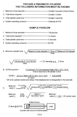

Sizing pneumatic cylinders
The procedure for sizing air cylinders is very similar to that for sizing hydraulic cylinders. One major difference: most plant air systems operate around 100 to 120 psi with approximately 80 psi readily available at the machine site. This gives little or no leeway for selecting operating pressure.
Also, because a compressor is part of the plant facilities, the number of cubic feet per minute (cfm) of air available for a single air circuit usually is many times that required. It is good practice though, to check for adequate flow capacity at the machine location.
The other items needed to design an air circuit are maximum force required, cylinder stroke, and cycle time. With this information, sizing cylinders, valves, and piping is simple.
To calculate the cylinder bore required, use the formula given at A in Chart 6-2. Notice the 1.25 multiplier on the force line. For an air cylinder to move at a nominal rate, it needs approximately 25% greater thrust than the force required to just offset the load. When the cylinder must move rapidly, provide a force up to twice that required to simply balance the load.
The reason for this added force can be illustrated by the example of filling an empty tank from a tank at 100 psi. When air first starts to transfer, the high pressure difference between the two tanks produces fast flow. As the pressures in the tanks get closer, the rate of transfer slows. The last 5 to 10 psi of transfer takes a long time. As the tank pressures get close to equal, there is less reason for transfer because the pressure difference is so low.
At a system pressure of 80 psi, if an air cylinder needs 78 psi to balance the load, there is only a 2-psi differential to move fluid into the cylinder. If the cylinder moves at all, the motion will be very slow and intermittent. If pressure differential increases – either from higher inlet pressure or lower load – the cylinder starts to move smoothly and steadily. The greater the differential, the faster the cylinder strokes. (Note that once cylinder force is twice the load balance, any increase in speed due to higher pressure is minimal.)
Substituting the 1.25 multiplier in the formula produces a cylinder bore of 1.72 in. minimum. Choose a 2-in. bore cylinder because it is the next standard size greater than 1.72 in.
To size the valve, use the flow coefficient (or Cv) rating formula. (The Cv factor is an expression of how many gallons of water pass through a certain valve . . . from inlet to outlet . . . at a certain pressure differential.) Valve manufacturers use many ways to report Cv and some may be confusing. Always look at the pressure drop allowed when investigating the Cv, to be able to compare different brands intelligently.
The formula indicates that a valve with 1/8-in. ports is big enough to cycle the 2-in. bore cylinder out 14 in. and back in 4 seconds.
There are many charts in data books as well as valve manufacturers’ catalogs that take the drudgery out of sizing valves and pipes. There are several computer programs as well to help in proper sizing of components.

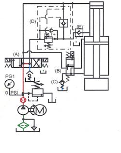

The circuit in Figure 6-13 illustrates another way to operate at high speed for extension and retraction at low force, with high tonnage available at any point along the extension stroke. The unmatched tandem cylinder has attached piston rods so the small-bore cylinder can retract both the large-bore cylinder and the load. The small-bore cylinder needs only a small volume of fluid to extend and retract at high speed, while both cylinders can produce high tonnage.
Figure 6-13. Using an unmatched tandem cylinder for high speed and high force – at rest with pump running.
Energizing the extend solenoid on valve A in Figure 6-14 causes the small-bore cylinder to extend rapidly, in regeneration. This moves the large-bore cylinder and platen downward. As the platen lowers, oil in the large-bore cylinder transfers through valve B to the large-bore cylinder’s opposite end.
Figure 6-14. Using an unmatched tandem cylinder for high speed and high force – fast-forward mode.
When the load meets resistance or contacts a limit switch, Figure 6-15, valve B’s solenoid also energizes – sending pump flow to both cylinders. During this part of the cycle, speed slows and tonnage increases. (The large-bore cylinder transferred oil during the high-speed portion of the cycle to ready it for the high-force portion of the stroke.) During the high-force portion of the cycle, oil from the mounting end of the large cylinder returns to tank. Because the large bore cylinder exhausts during this part of the cycle, it receives fresh oil for every high-pressure stroke.
Figure 6-15. Using an unmatched tandem cylinder for high speed and high force – high-force mode.
To retract the cylinder at high speed, energize the retract solenoid on valve A, Figure 6-16. The pump retracts the small-bore cylinder, which also retracts the large-bore cylinder and platen. While the large-bore cylinder retracts, fluid in it again flows from end to end, so the cylinder stays full. Backpressure check valve C in the tank line keeps oil from draining to tank when it is lower than the cylinder.
Figure 6-16. Using an unmatched tandem cylinder for high speed and high force – fast-retraction mode.
Note externally drained pilot-operated check valve E at the rod end of the small-bore cylinder. With a running-away load, some means is needed to hold the cylinder in place while the circuit is at rest. This cylinder might free fall when the directional valve centers without some way to keep it from trying to regenerate. If the load is heavy, use an externally drained counterbalance valve to stop the pilot-operated check valve from chattering.
One potential problem with this arrangement is the length of the tandem cylinder. For long strokes, the more-than-double length of the tandem cylinder could cause height or length interference. Also, the rod size of the large-bore cylinder determines the smallest bore of the small cylinder. For example: if the double rod-end cylinder has a 10-in. bore with a 5-in. rod, then the smallest single-rod cylinder would require a 7-in. bore.
For the arrangement just shown and sized, the force at 3000 psi is approximately 292,000 lb. A pump flow of 30 gpm would result in a cylinder cycle time of about 15 seconds . . . with a 40-in. travel stroke and a 3/4-in. tonnage stroke.

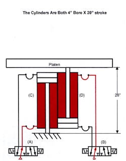

Figures 6-17 and 6-18 show two air cylinders facing in opposite directions with their bodies attached side by side. This orientation makes the total stroke additive, while the retracted length is that of a single cylinder. (Assuming that both cylinders have a 20-in. stroke, the platen’s starting position in Figure 6-17 is about 20 inches lower with this arrangement than it would be with a single 40-in. stroke cylinder.) Many applications use standard NFPA-design cylinders in such an arrangement. With this circuit there is constant force and speed, compact mounting, and double-acting operation. The only special requirement is to specify valves that give smooth action and control. If the circuit used two directional valves, the platen could have three positive positions (if required). With different stroke lengths, these cylinders could stop the platen positively in four positions.
Figure 6-17. Using two cylinders for double stroke from half the height – both cylinders retracted.
Using a single valve for extra stroke only requires meter-out flow controls at each cylinder port for near-simultaneous movement. This arrangement works smoothly and eliminates jerking when the cylinders bottom out at different times.
With hydraulic cylinders, use a spool-type flow divider for simultaneous movement and closely synchronized end of stroke stopping. (Chapter 11 will cover flow divider circuits.)
Because both cylinder bodies move, use flexible fluid lines. Also, arrange to guide the platen or machine member to keep excess side-loading off the cylinders.
