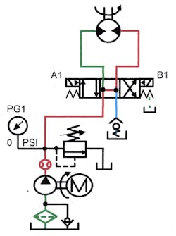

Fig. 12-6. Bi-directional hydraulic motor at rest with pump running.

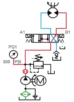

Fig. 12-7. Bi-directional hydraulic motor running clockwise.

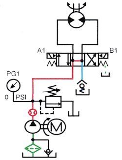

Figure 12-14 shows a solenoid-operated control circuit for a small, uni-directional hydraulic motor. Energizing the solenoid starts and runs the motor. Deenergizing the solenoid allows the motor to coast to a stop. Depending on the type and amount of load, starting and stopping the motor may be anywhere between smooth and abrupt.
Fig. 12-14. Small hydraulic motor circuit with single direction of rotation.

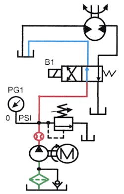

Figure 12-15 shows how to control a large uni-directional hydraulic motor via a normally open, solenoid-operated relief valve. This circuit is less expensive than one that uses a large directional valve and a relief valve. Solenoid-operated relief valves discharge pump flow to tank at about 20 to 50 psi, normally keeping the motor stopped. Energizing the solenoid on the relief valve causes it to start closing. The closing of the relief valve builds pressure and the motor starts to turn. If pressure tries to go higher than the relief setting, this valve stays partially open, which gives the motor time to accelerate. When the motor is at maximum speed, pressure drops, and the relief valve closes completely, directing all pump flow to the motor inlet. If the system pressure tries to go higher than the relief setting, the valve opens to protect the circuit. De-energizing the solenoid on the relief valve allows the motor to coast to a stop without cavitation.
Fig. 12-15. Large hydraulic motor circuit with single direction of rotation.
Note that if the motor can turn at the low unloading pressure (20 to 50 psi), it may never stop completely. Use a brake valve at the motor outlet to keep it from turning if this situation occurs.

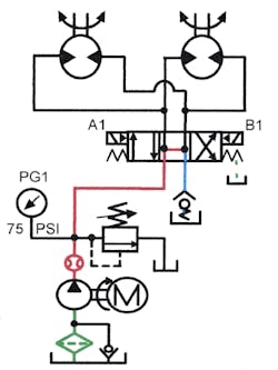

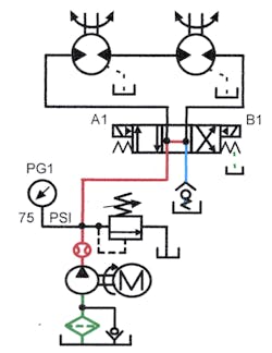

Figure 12-16 shows two hydraulic motors in a parallel circuit. Supplying two or more motors from a single valve lets the fluid follow the path of least resistance. Synchronizing the motors with a flow divider (Chapter 11) or by a mechanical linkage would keep them together. With parallel circuits, all motors have full torque but only get a portion of pump flow. In other words, the motors have equal power at reduced speed.
Fig. 12-16. Parallel hydraulic motor circuit with bi-directional rotation.

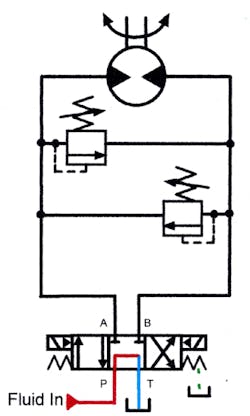

Circuits for hydraulic motors with over-running loads

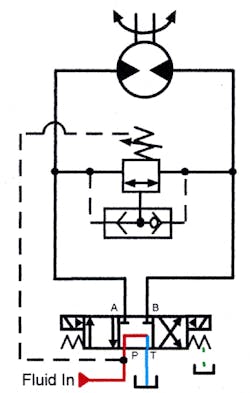

Figure 12-18 depicts the most common way to slow a hydraulic motor with an over-running load. Notice that the directional valve has blocked ports A and B. This valve’s center condition makes a motor stop abruptly, which could cause high shock and physical damage. Shock occurs because the motor becomes a fixed-displacement pump without a relief valve to protect it from over pressure. The cross-port relief valve shown in the Figure allows fluid from the over-pressured port to go to the opposite motor port. The reason for piping the outlet of the reliefs to the opposite motor port is to keep it from cavitating as the motor decelerates. Cross-port reliefs are available with both relief valves in a common housing to save piping time and reduce potential leakage points.
Fig. 12-18. Dual cross-port relief valves.

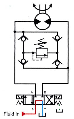

Set the pressure for the cross-port relief valve the same or higher than system pressure. This gives full starting torque and smooth controlled stopping. When the cross-port relief valve pressure setting is lower than system pressure, it reduces starting and maximum running torque. The only reason for a lower setting at the cross-port reliefs is for longer coasting time. The higher the pressure setting of the cross-port reliefs, the more quickly the motor stops.
By deenergizing the directional valve with the motor at full speed, outlet flow from the motor is blocked and pressure increases. When pressure reaches the setting of the cross-port relief valve, the valve opens and allows flow to the opposite motor port. Backpressure equal to or greater than what it took to start the motor now holds back against the load. The energy of the over-running load dissipates over a short period of time to eliminate shock.

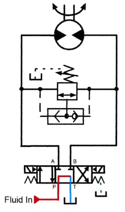

Fig. 12-19. Single cross-port relief valve with check valves.
Dual cross-port relief valves allow different stopping times for the two directions of rotation. If this feature is not required, use the single relief and check valves shown in Figure 12-19. With this circuit, pressure is set only once for both directions of rotation. Notice that the check valves direct flow through the relief from either motor port to the opposite motor port. This check valve arrangement is available in a manifold to save piping time.

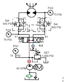

Figure 12-22 depicts brake valves (sometimes called over-center valves) piped in the lines between the motor and the directional valve. To control the motor in both directions of rotation, install two brake valves as shown.
Fig. 12-22. Internally and externally piloted brake valve – at rest with pump running.
A brake valve is an internally and externally pilot-operated pressure-control valve. The internal pilot works on a small area and thus requires a high pilot pressure. The external pilot works on a larger area at a much lower pilot pressure. A common ratio for pilot areas is 8:1. With an 8:1 pilot-area difference, the valve allows fluid to pass when the internal pilot pressure is 1000 psi or the external pilot pressure is 125 psi. Always note the internal pilot pressure setting on the schematic diagram. The internal pilot setting indicates the amount of backpressure at the motor during deceleration.
Brake valve pressure setting is independent of system pressure. This means a lower or higher pressure on the brake valve does not affect the system’s maximum operating pressure.
Brake valves are necessary when a hydraulic motor’s load tries to make it go faster than the pump or control circuit feeds it. In a winch application, a directional valve shifts to lower a load. Without a brake valve, the winch load falls freely, the motor cavitates, and the circuit is unsafe. Most winch applications require only one brake valve.

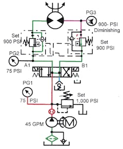

Figure 12-22 shows a brake-valve circuit at rest. The brake valves stay closed because their pressure settings are high enough to stop the load. Notice the internal pilot lines on each brake valve that sense pressure in the motor outlet lines. Also, each brake valve has an external pilot line from the opposite motor flow line. Bypass check valves in each brake valve allow free-flow return during reverse flow.
NOTE: Never depend on any valves to stop and hold a hydraulic motor. Hydraulic motors always have internal leakage and will continue to turn slowly without some external braking arrangement. Spring-on, pilot-to-release, multiple-disk brakes are one method of holding a hydraulic motor stationary.
Figure 12-23 shows the brake-valve circuit after shifting the directional valve. Oil entering the left motor port must be at least 112 psi (1/8 of the 900-psi setting) to open the right brake valve. When the load is over-running, inlet pressure to the motor stays at 112 psi to hold the outlet brake valve open. When pressure at the inlet drops below 112 psi, the opposite brake valve closes to retard motor movement. During this portion of the cycle, backpressure keeps the motor from running away. When pressure tries to go above 112 psi, the opposite brake valve opens wide -- dropping all backpressure. As the motor is turning under power, the external pilot supply controls the brake valve.
Fig. 12-23. Internally and externally piloted brake valve – with hydraulic motor running.
When the directional valve centers, as depicted in Figure 12-24, external pilot supply to the brake valve drops. The brake valve tries to close, causing pressure to increase at the motor outlet port. When outlet pressure reaches 900 psi, it forces the brake valve open and holds back against the over-running load. Because 900 psi is more than enough to stop the load, the motor decelerates to a smooth controlled stop.
Fig. 12-24. Internally and externally piloted brake valve – with hydraulic motor stopped.
The brake valve only holds the motor back if it is trying to run away. This means little or no energy loss as the motor turns under load — and no running away when the load tries to turn the motor. This action is identical to that of a counterbalance circuit for a cylinder.
Because each brake valve is independent, a different pressure setting at each valve is possible.

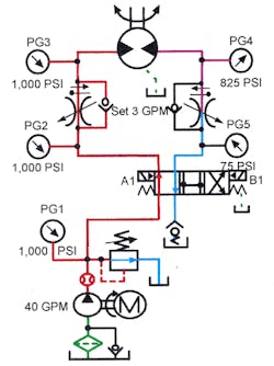

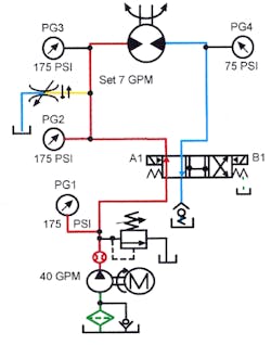

Figure 12-25 shows a motor circuit with meter-in flow controls. This is the preferred way to control the speed of hydraulic motors. Use a meter-in circuit whenever possible because the motor's internal leakage passes to the low-pressure port through internal check valves. This type circuit makes a case drain or high-pressure shaft seal unnecessary. There is little or no backpressure at the outlet of the motor to cause high pressure at the shaft seal.
Fig. 12-25. Meter-in flow-control circuit for a hydraulic motor.
When supplied with 3 gpm at 100 psi, the motor turns at low torque. Its speed is approximately 200 rpm. When the motor load increases and pressure drop across it climbs, increased internal leakage causes speed to slow by as much as 10 to 30%. (The lower the efficiency of the motor, the greater the change in speed.) Motors that turn very slowly may even stop as pressure drop increases. Fast-turning motors may lose speed but continue rotating. As discussed in the section on flow controls, a pressure-compensated valve keeps a constant flow to the motor but cannot offset its internal leakage.

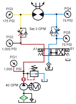

The meter-out circuit shown in Figure 12-27 provides the most accurate speed control. Note that heat generation is high, even with a pressure-compensated pump, but the resulting speed control is very accurate. Use pressure-compensated flow controls and motors with external case drains for the greatest accuracy and longest motor life. Oil enters the motor at low torque and the pressure drop across it is low. Even though high inlet pressure with high backpressure causes high internal leakage, pump input makes up for it. Accurately controlled fluid leaving the motor keeps speed constant because the pressure-compensated flow control maintains a steady flow. When the motor loads, pressure drop across it decreases. Internal leakage decreases but the amount of oil leaving the outlet port stays constant. As long as outlet flow does not change, speed stays the same.

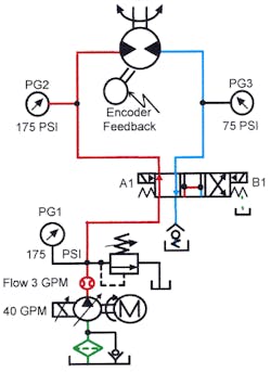

Figure 12-30 shows a variable-displacement bi-directional pump driving a bi-directional hydraulic motor in a closed-loop system. This circuit is commonly known as a hydrostatic transmission. The bi-directional hydraulic pump can produce up to full flow from either port, eliminating the need for directional or flow control valves. When the pump strokes to produce flow from one port, the motor starts turning a given direction. With controlled pump stroking, the motor starts and accelerates smoothly. The amount of pump stroke controls motor rpm and pressure is just enough to make the motor turn. With high-efficiency components, this system generates little heat, eliminating the need for large reservoirs while it gives infinitely variable speed and torque.
Fig. 12-30. Bidirectional hydraulic motor driven by a bidirectional pump (shown with motor at rest and pump running).
Due to internal leakage of the pump and motor, the circuit is not a true closed loop. Without leakage makeup, the circuit would quickly run dry, operate intermittently, and damage its parts. To keep the closed loop full, fixed-displacement charge pump A supplies flow through check valves C1 and C2 to the low-pressure side of the circuit. Charge oil keeps the pump inlet fully supplied, preventing cavitation. When the motor stops, excess oil from the charge pump goes to tank through relief valve B. Oil from the charge pump often operates the pump stroking mechanism, plus other circuits on the machine.
