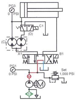

Motor-type flow divider as an intensifier
A motor-type flow divider intensifies pressure at one outlet when the other outlet is at a lower or no pressure. In the case of a 2-outlet motor flow divider with equal displacements, when inlet pressure is 1000 psi, one outlet can be at 2000 psi while the other outlet is 0 psi. While pressure doubles, flow from the intensified outlet is one half that at the inlet. The energy from the zero outlet motor transfers to the other motor to produce intensified pressure.
Fig. 13-22. Motor-type flow divider used as an intensifier. At rest with pump running.
With more than one section going to tank, say from a 4-outlet divider with three outlets to tank, intensification would be four times. While the intensified fluid is four times inlet pressure, volume is only one-fourth inlet flow.
Using motor dividers with unequal sections is another way to get high intensification. If the motor in one section discharges 3 gpm to tank and the other section sends 1 gpm, intensification is still 4:1.
Figures 13-22 through 25 show how to use this feature of motor-type flow dividers in a circuit. This circuit has equal flow divider C and 3-way directional valve D in the cylinder cap end line. In the at-rest condition, both outlets of the flow divider connect to the cap-end port.
Fig. 13-23. Motor-type flow divider used as an intensifier. Cylinder extending at full speed.
In Figure 13-23, the cylinder is extending at full speed and low thrust. Shifting solenoid A1 of the directional valve ports oil through one side of the divider and 3-way valve to the rod-end port. Fluid from the other side of the divider goes directly to the cylinder rod-end port. Size the pump and valves to provide enough flow for the speed required in the fast-forward portion of the cycle. Normally, motor horsepower is low for a cylinder moving a light load.

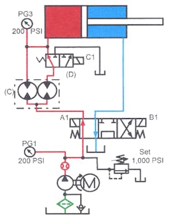

Fig. 13-24. Motor-type flow divider used as an intensifier. Cylinder extending at full power.
When the cylinder makes a limit switch, as in Figure 13-24, it energizes solenoid C1 on the 3-way valve. When the valve shifts, oil from one section of the motor flow divider goes to tank. Pressure doubles, while cylinder speed drops to half what it was before energizing solenoid C1.
This circuit works best on actuators that do not stall. Using this setup for a fast advance and clamping operation might result in excess heat from internal leakage in the flow divider during the clamping part of the cycle.

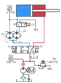

Fig. 13-25. Motor-type flow divider used as an intensifier. Cylinder retracting.
Energizing solenoid B1, Figure 13-25, makes the cylinder retract. Oil from the cap-end port flows through both sections of the flow divider, then back to tank through the directional valve.

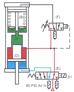

Special air-oil intensifier cylinder
Some manufacturers build self-contained, air-driven, high-force hydraulic cylinders. These units look like a very long stroke air cylinder. Typically, they have 2 to 10 in. total strokes with 1.0- to 1.5-in. high-force strokes. They often replace a hydraulic unit on a machine that needs high tonnage for one operation on an otherwise air-powered circuit. Because these special intensifiers are self-contained, they only require an air supply and a signal to start them. They have sealed reservoirs so they operate in any position. They normally have an indicator to monitor oil volume for preventive maintenance. According to bore size and stroke length, cycle rates go as high as 150 per minute. The bigger the bore and longer the stroke, the fewer the cycles per minute.
Fig. 13-26. Special air-oil intensifier cylinder. System on and ready.
As with other air-oil devices, return power is only cylinder net rod-end area multiplied by air pressure. The unit may have 50 tons to punch a hole but only 0.5 ton to retract the punch. For high retraction force use springs or urethane strippers, or add short-stroke return cylinders.
Figure 13-26 has a cutaway view of the intensifier cylinder at rest. (This view only shows function, not necessarily an actual assembly.) Air piston and rod C with attached hydraulic ram D move rapidly at low force to the work and return the tooling at the end of the cycle. Ram D is the area that intensified oil pushes on to get the short, high-force work stroke. Spring-loaded, floating piston A forms the top of a variable-volume, sealed oil tank. Spring-return air piston B drives its piston rod into trapped oil to intensify pressure for the work stroke. Directional control valve E cycles the advance and return strokes of cylinder C, and supplies air to pilot sequence valve F, starting the high-pressure work stroke.
Fig. 13-27. Special air-oil intensifier cylinder. Fast advance at low force.
When directional valve Eshifts, as in Figure 13-27, air piston-and-rod C extends the tooling to the work rapidly. As the piston-and-rod extend, ram D advances and fills with oil from the variable-volume tank. Vacuum forms in the chamber behind ram D, and the spring behind the floating piston forces oil into the void. Piston-and-rod C continues to advance and oil transfers until the work is met. This low-force advance stroke moves quickly (and uses air flow controls when necessary). Seals on ram D separate oil and air.

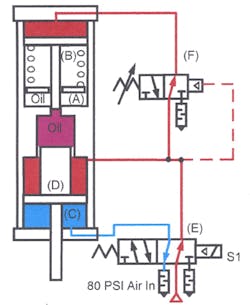

Fig. 13-28. Special air-oil intensifier cylinder. Starting high-pressure cycle.
Figure 13-28 shows the intensifier after contacting the work. When air piston-and-rodC stop against the work, pressure build-up behind the piston shifts sequence valve F. When sequence valve F shifts, shop air extends spring-return air piston B. The first movement of the spring-loaded air piston advances the rod to the flow port connecting the tank to the chamber behind hydraulic ram D. As the rod enters this flow port, it passes through a resilient seal, stopping flow to tank and sealing the chamber behind ram D. This action automatically isolates the low-pressure chamber — eliminating the need for a pilot-operated check valve.

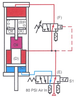

Fig. 13-29. Special air-oil intensifier cylinder extending at low speed with high force.
As the spring-return air piston continues to extend, as in Figure 13-29, the rod displaces oil in the chamber behind hydraulic ram D. In this case, the area of spring-return piston B is 15 times the area of the rod entering the sealed chamber. The air piston and rod continue to displace oil and move hydraulic ram D until the pressure behind the ram becomes 15 times greater than the air pressure on the piston. The stroke of spring-return piston B and the diameter of its rod set the maximum high-pressure work stroke. The higher the intensification ratio and the shorter the stroke, the less the high-pressure stroke capability.
Deenergizing directional valve E allows the spring loaded air piston and the work cylinder to return home. The work cylinder returns slowly while spring return air piston B retracts past the high-pressure seal.
