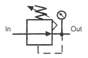

When one branch of a fluid power circuit must operate at a lower pressure, use a reducing valve to provide it. Reducing valves control their outlet or downstream pressure only.

A standard reducing valve is normally open. When downstream pressure goes higher than its setting, the valve closes, blocking flow. If pressure downstream tries to increase — say due to resistance from an opposing cylinder — a reducing valve also blocks reverse flow. Escalating pressure in the downstream line continues until something bursts or gets mechanically damaged.

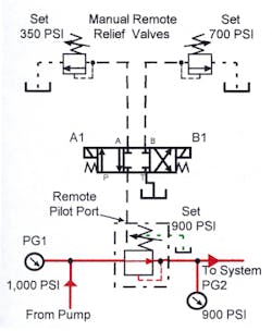

Remotely operating a pressure-reducing valve
Pilot-operated reducing valves have a remote pressure-control port. Connecting this port to other pressure valves allows pressure to be changed from a remote location. For example, Figure 16-12 shows a reducing valve with a directional valve and two remote relief valves connected to the remote-control port. With the directional control valve in its center position, set the pressure with the knob on the reducing valve. This setting is always the highest reduced pressure for the circuit.
Figure 16-12. Using remote pilot port for three different system pressures (no solenoids energized).
Energizing solenoid A1 of the directional valve, as in Figure 16-13, connects the remote pilot port to the remote relief valve SET 350 psi. Pressure in the system now drops to and holds at 350 psi. Energizing solenoid B1 of the directional valve, as in Figure 16-14, connects the remote pilot port to the remote relief valve SET 700 psi. Pressure in the system now rises to 700 psi and holds at that level.
Figure 16-13. Using remote pilot port for three different system pressures (solenoid A1 energized).
