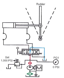

Simple mechanical servocircuit
Figure 21.3 shows a simple mechanical servocircuit that controls rudder movement on tugboats. The rudder on a tugboat is big and directly in the prop wash, so the operator must have help in moving and controlling it. The lever-operated hydraulic valve in this circuit directs hydraulic power to move the rudder via a double-acting cylinder. If the valve is in the pilothouse, it does not show rudder position. Without knowing the rudder angle, engaging the propellers might be disastrous in some situations.
Figure 21-3. Simple manual rudder-control circuit -- at rest with pump running.
Figures 21.4 through 21.6 show an inexpensive manual rudder-control circuit. This circuit uses the same lever-operated control valve in Figure 21.3, but here it mounts on the rod of the double-acting cylinder. The operator controls the valve from the pilothouse with a lever called a “tiller.” A cable and pulley system connects the tiller to the valve. This all sounds a little crude but it works quite well on small boats.
Figure 21-4. Mechanical servo rudder-control circuit -- at rest with pump running.
The clevis-mounted double-acting cylinder attaches to the boat frame and the rudder lever. The lever-operated valve mounts directly to the cylinder rod so it moves with the rudder lever. When the operator moves the tiller to the right, as in Figure 21.5, the lever on the valve moves to the right. When the lever moves, it shifts the directional valve and ports oil from the pump to the cylinder's cap end and returns oil to tank from the rod end. The cylinder moves the rudder to the right as long as the operator keeps moving the tiller.
When the operator stops moving the tiller, as in Figure 21.6, the directional valve, moving with the cylinder rod, catches up and centers. When tiller movement ceases, the rudder stops and holds. The rudder and tiller stay in this position until the operator steers in a different direction. At all times the operator knows rudder position by looking at the tiller angle.

The mechanical servosystem is nothing more than a force multiplier. In this case, the formerly hard-to-move rudder now moves with slight manual force. At the same time, the tiller position indicates the rudder angle because of mechanical linkage feedback.
An automobile power-steering system uses similar circuitry. Steering wheel movement shifts a directional valve that powers a cylinder to move the steering mechanism. When the steering wheel moves, front wheel angle changes. When steering wheel motion ceases the front wheels stop and hold.
