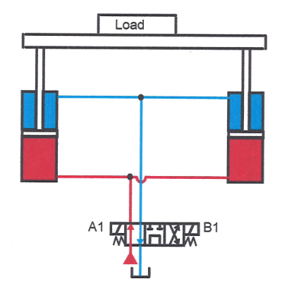

Synchronizing with flow controls
The circuit in Figure 22-1 has no controls except the directional valve. If the pipes are all the same relative size and all the same length; if the load is centered; and if friction of all parts is identical, the cylinders might travel exactly together. Some of these variables are controllable, but things like friction may change even during a single cycle. With the setup in Figure 22.1, the cylinders actually move one at a time until they hit end of stroke or bind up mechanically.

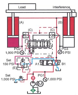

With the off-center load shown in Figure 22-2, the cylinder farthest from the load would extend until it stroked out or locked up -- before the opposite cylinder starts to stroke.

With flow controls, the cylinders stay reasonably synchronized only if load position does not change. If the load moves, cylinder force must change to maintain synchronization. If load position change is infrequent, resetting flow controls is an option.
Even with hydraulics, another problem with uneven loads is what happens if the cylinder does not stroke all the way. If the cylinder stops in mid stroke, as in Figure 22-4, oil from the loaded cylinder can transfer to the opposite cylinder and throw the platen out of synchronization. Figure 22-5 shows pilot-operated check valves added to the cap-end lines to overcome oil transfer during mid-stroke stopping. With these check valves in place, oil cannot transfer when the cylinders stop in mid-stroke, so the cylinders maintain their positions.
Another problem with flow-control synchronization is the maximum lifting force. With two identical cylinders positioned parallel to each other, the platen should be able to lift twice each cylinder's force. However, this is only true if the load is centered. With a double load positioned over one cylinder, that cylinder would stall while the opposite cylinder tries to extend. When using flow-control synchronization, size each cylinder to carry the whole load if the load might get off center.

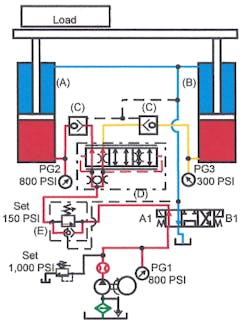

Double-rod end cylinders in series
Figure 22-7 shows a fairly accurate way of synchronizing cylinders using double-rod end cylinders piped in series. Oil from the directional valve extends the first cylinder, the first cylinder's top port supplies oil to extend the second cylinder, and the second cylinder's top port connects to the other port of the directional valve. In this arrangement, oil trapped between the cylinders must have a means of replenishing or draining. As this circuit operates, cylinder seal leakage either depletes the trapped volume or adds to it. Either situation alters synchronization adversely.
Figure 22-7. Synchronizing circuit with double-rod end cylinders in series flow -- at rest with pump running.
In Figure 22-7, when 2-position, spring-centered, single-solenoid, tandem-center leveling valve D is deenergized, it allows oil to flow from cylinder (A) to cylinder (E). The valve is deenergized while the cylinders extend and retract to do work. (Figure 22-10 shows how the cylinders are leveled at the end of a cycle.)
Energizing solenoid A1 of the main directional valve, as in Figure 22-8, sends oil to cylinder (A) , causing it to extend. Oil from the opposite end of cylinder (A) flows through leveling valve (D) to the push end of cylinder (E). Oil from the opposite end of cylinder (E) flows to tank through the main directional valve. When the trapped volume is completely full and if all seals do not leak, the cylinders synchronize nearly perfectly, regardless of load position.
To retract the cylinders, energize solenoid B1 of the main directional valve as in Figure 22-9. This sends oil to the retract side of cylinder (E). Oil from the opposite end of cylinder (E) flows through leveling valve (D) to the top of cylinder (A). Oil from the opposite end of cylinder (A)flows to tank through the counterbalance valve and main directional valve.
Figure 22-10 shows how the cylinders maintain synchronization as they cycle. When the platen nears bottom, it contacts limit switches B and F. If the switches make simultaneously, no leveling occurs. If one limit switch makes before the other, the cylinders obviously are out of synchronization, so solenoid C1 on the leveling valve energizes. With solenoids B1 and C1 energized, pump oil flows to the retract sides of cylinders (A) and (E), forcing them to retract fully. Cylinders (A) and (E) can retract because the extend sides of both cylinders have a direct path to tank. When both limit switches make, the leveling valve and retract solenoids deenergize. (This leveling circuit also works for horizontally mounted cylinders.)
With series cylinder synchronizing, load placement is not important. The cylinders stay level regardless of load position or weight. The only things a heavy off-center load might cause are more seal leakage, or oil volume changes due to compressibility.
It is important to note that, because the cylinders are in series, they each have to be able to lift the total load. No matter the load placement, or the number of cylinders in series, each one must be capable of lifting the entire load. At the same time only one cylinder's volume is considered when calculating pump flow.

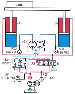

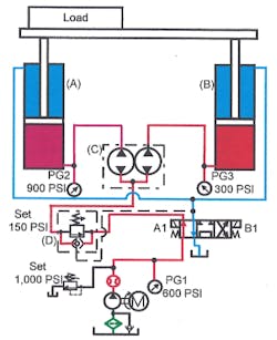

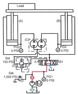

Motor-type flow divider synchronizing circuit
Motor-type flow dividers do not waste energy and are more versatile. One motor-type flow divider can splits flow from a pump and run two or more cylinders in unison. Plus, they offer multiple outlets -- up to ten or more -- and can pass unequal flows when required.
A motor-type flow divider consists of two or more hydraulic motors in one housing. The motors have a common shaft. Thus, when one motor turns, all motors turn. The motors share a common inlet but have separate outlets. Fluid from the pump enters all motors at once, rotating then in unison. If the motors are the same size, output from each section is an equal portion of inlet oil. Because a mechanical motor -- instead of an orifice -- splits flow, there is no energy loss due to different outlet pressures. Figure 22-25 shows a motor-type flow divider synchronizing two cylinders. The flow divider is installed between the directional valve and the cylinders in this circuit.
In Figure 22-26, solenoid A1 is energized to shift the 4-way directional valve. This sends oil to the flow divider, which sends equal volumes to each cylinder. The accuracy of motor-type flow dividers depends on the amount of pressure difference at the outlets. The motors have internal slippage that increases as pressure drop increases. The greater the pressure difference, the greater the flow difference and loss of synchronization.
In Figure 22-27, the cylinders are retracting. Energizing solenoid B1 on the directional valve sends oil from the pump to the cylinders' rod ends. As the cylinders retract, oil flows from the cylinders' cap ends through the flow divider to tank. The flow divider combines the cylinder flows and maintains synchronization when the cylinders travel freely.
If one cylinder binds up and stops traveling, as in Figure 22-28, all oil from the pump goes to the free-moving cylinder. The flow divider section that is not getting oil from the stopped cylinder continues to turn and cavitate, causing the free cylinder to retract at twice speed. When there is a chance of cylinder binding, install a motor-type flow divider at both ends of the cylinders. A flow divider on the rod end forces the binding cylinder to synchronize or stalls them both.
The internal slip of motor-type flow dividers is usually sufficient to level the cylinders. Another option is integral relief valves that allow fluid to bypass a motor at a predetermined adjustable pressure.
As mentioned, an advantage of motor-type flow dividers is that they waste little energy. Notice the gauge values in Figure 22-26. The left cylinder requires 900 psi, while the right cylinder only needs 300 psi. With those conditions, the inlet pressure to a spool-type flow divider has to be 900 psi. With a motor-type flow divider, the inlet pressure only has to be 600 psi. Because the motor-type flow divider has a mechanical link through a common shaft, energy transfer between sections lowers the required pressure at the inlet.
Another advantage is that motor-type flow dividers with two, three, even ten or more outlets are common. Instead of stacking 2-outlet spool-type dividers, use only one multiple-outlet motor-type flow divider for many circuits.
One caution: motor-type flow dividers will intensify outlet pressure as they operate. (See Chapter 11 for an explanation of motor-type flow divider intensification.) With a 2-outlet equal-flow divider, if relief valve pressure is over half the maximum rated pressure of any component it feeds, install a relief valve at each outlet. The outlet relief valves protect the cylinders, valves, and lines from excess pressure.

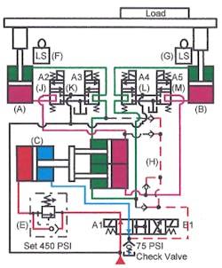

Master-and-slave cylinder synchronizing circuit
Figures 22-29 through 32 show one of the most accurate ways to hydraulically synchronize cylinders. Figure 22-29 shows the circuit at rest. Cylinder (C) -- mechanically linked to two cylinders (D) -- provides the driving force. The (D) cylinders have the same bore, stroke, and rod diameter as working cylinders (A) and (B). One cylinder (D) connects to cylinder (A), while the other cylinder (D) connects to cylinder (B). In case of external leakage, makeup check valves (H) let oil into the dead areas of cylinders (A), (B), and(D) at low pressure. A 75-psi backpressure check valve in the tank line gives sufficient pressure to make sure the trapped oil volume stays full. Leveling valves (J) through (M) retract the cylinders to home position when they get out of phase. Limit switches (F) and (G) indicate cylinder home positions and operate the leveling valves when the cylinders get out of synchronization. Counterbalance valve (E) stops the cylinders from running away while they retract.
Force from cylinder (C) is enough to do the whole operation by itself. This cylinder produces all the force and passes it on to slave cylinder (D), then to the working cylinders (A) and (B).
The location of the load on the platen affects synchronization only slightly. Energy transfer from the master/slave linkage moves the same volume of oil regardless of pressure. Cylinder (A)operates at twice pressure with the load above it as with a centered load. To protect the cylinders from overpressure, set the relief valve for no more than half the cylinder pressure rating.
Figure 22-30 shows solenoid A1on the 4-way directional valve shifted to extend cylinder (C). Cylinder (C) pushes cylinders (D), and oil from the cap ends of cylinders (D)flows equally to the cap ends of cylinders (A)and (B). Oil from the rod ends of cylinders (A)and (B)returns to the rod sides of cylinders (D). Cylinders (A)and (B) extend in unison if cylinder (C) has enough power to do the job. If one working cylinder stalls, both stop.
To retract the working cylinders, energize solenoid B1 on the 4-way directional valve as in Figure 22-31. Cylinder (C) then retracts and pulls both slave cylinders (D) back, forcing working cylinders (A) and(B) to retract also.
If the working cylinders get out of synchronization, the circuit diagram in Figure 22-32 shows how they level. While solenoid B1 on the 4-way directional valve stays shifted, energize solenoids A2 through A5 on directional valves (J) through (M). This directs pump oil to the rod sides of cylinders (A), (B) and(C), and to the cap sides of both (D) cylinders. At the same time, oil from the cap sides of cylinders (A), (B) and(C) and the rod sides of both cylinders (D) flows to tank. In this condition, the pump forces all cylinders to their home positions, ready for the next cycle.
This circuit is an accurate but expensive way to synchronize cylinders. One advantage is that the master and slave cylinder can be located remotely, to leave the work area less cluttered. Also, energy transfer minimizes the required cylinder size and still handles off-center loads.

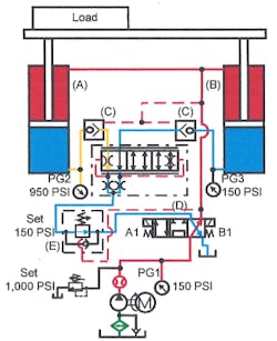

Tandem-cylinder synchronizing circuit
Figure 22.-3 shows another very accurate way to synchronize cylinders. The tandem cylinders in this circuit must meet in center even when they run into unequal forces.
Tandem cylinders consist of two cylinders in one housing. They have four ports and the back cylinder is single-rod end while the front cylinder is double-rod end. Because the front cylinder is double-rod end, it has equal areas and volumes on both sides of the piston.
Notice the 4-way directional valve supplies the single-rod cylinders in a conventional manner. The double-rod cylinders have the front port of the left cylinder connected to the back port of the right cylinder and the front port of the right cylinder connected to the back port of the left cylinder.
The tandem cylinders move in unison and transfer energy because hydraulic flow ties them together. If either cylinder stalls, both cylinders stop. Before the cylinders stop, energy transfers through the tandem cylinders and tries to force the lagging cylinder to do its work. The lagging cylinder may see as much as double force before stalling.
The two check valves (C), fed from a 75-psi backpressure check valve in the tank line, allow makeup oil into the trapped volume of the tandem cylinders. The pump makes up for leakage in the trapped volume through check valves (C). Makeup pressure is equal on both sides of both cylinders so the 75 psi has no effect on them. Always furnish bleed ports at both ends of the tandem cylinders to purge any trapped air.
The 2-way, normally closed directional valve (D) between the tandem cylinder connecting lines opens to level the cylinders at one end of the stroke. Leakage at the cylinder piston seals may allow the cylinders to get out of phase. Valve (D) opens when limit switches (E) and(F) do not make simultaneously as the cylinders retract. When one limit makes first, valve (D) opens and allows fluid transfer from one end of the double-rod end cylinder to the other, until both limits make.
In Figure 22-34, solenoid A1 of the 4-way directional valve is energized and the cylinders extend. As they extend, oil transfer in the tandem cylinders maintains near perfect synchronization. If either cylinder tries to lag, power transfers hydraulically through the tandem cylinder lines to keep them in unison. When the load is too great for both cylinders, they stall.
Figure 22-35 shows the cylinders retracting. Energizing solenoid B1 of the 4-way directional valve sends fluid to the rod ends of the single-rod cylinders. As the cylinders retract, the double-rod end cylinders cross piping keeps the machine in synchronization, the same as when they extend.
When the cylinders get close to home, they level or re-phase when necessary, as pictured in Figure 22-36. Limit switches (E) and (F) both have to make to center the 4-way directional valve. If one limit switch makes early, solenoid C1 of 2-way directional valve (D)energizes, allowing the lagging cylinder to transfer oil until it makes its limit switch.
This synchronizing circuit works equally well with air as the power source to the single-rod end cylinders. Use oil in the tandem cylinders because it does not compress. Oversize the oil flow lines for a velocity of 2 to 4 fps to maintain a reasonable speed. Install a makeup oil tank with check valves to feed the tandem cylinders when necessary.
