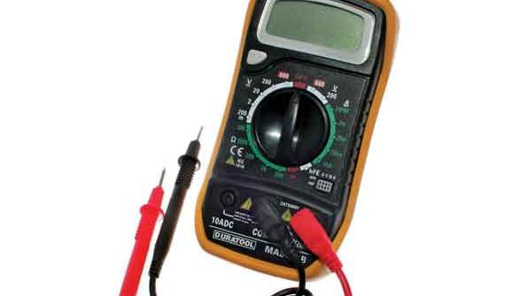

Figure 4. The digital multimeter is the instrument of choice in the well-equipped electrohydraulic tool kit.

A voltmeter always has two connections available to the user. Electrohydraulic practitioners will likely use a handheld digital multimeter. One of the two connections is labeled +, V, A, or O and connected to a red lead wire. The other is labeled “COMM” and is connected to a black lead wire. This practice helps keep the algebraic sign straight, which can be important, especially if automatic control systems will be used. The bottom line is that both leads must be connected to the circuit being tested in order to get a usable voltage reading. The digital multimeter is the instrument of choice in the well-equipped electrohydraulic tool kit.
