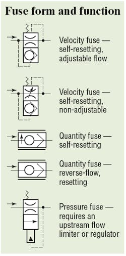

Hydraulic fuse is a general term given to three different types of devices — velocity fuses, quantity fuses, and pressure fuses.
Velocity fuses work by sensing flow across a control orifice when the pressure differential exceeds a predetermined amount (usually 50 psid). A spring-biased poppet closes, shutting flow to the damaged hydraulic circuit.
A velocity fuse requires a flow potential large enough to meet the differential pressure setting. The flow normally required to trip the fuse is 30% above the rated flow. This usually accommodates flow surges without tripping the fuse. Flow surges can be caused by sudden starts and stops, valve actuations, motor reversals, etc. The fuse allows reverse free flow. Depending on the system requirements, velocity fuses can reset automatically when the pressure is removed or with reverse flow.
An adjustable velocity fuse can optimize the fuse trip setting and can be externally adjusted to provide a flow trip setting without having to disconnect the hydraulic lines. Once the fusing flow is set, the housing can be locked for repetitive operation.
Quantity fuses are used in hydraulic circuits that have a limited fixed volume, a clutch or locking circuit, for example. A quantity fuse senses flow across two orifices sized to provide a specific volume. Quantity fuse volume generally is sized to be less than 1⁄2 gal. Refer to schematic 3 and 4.
Pressure-sensing fuses operate by sensing low pressure (low load) for valve actuation. Flow potential must be limited such that the outlet pressure does not exceed the fuse actuation pressure.
